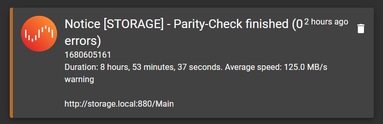

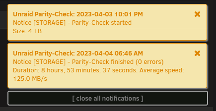

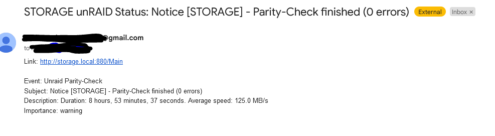

6.11.5 Notifications say 0 errors, Main and History says 2 errors.
Parity check happened last night, I'm setup to get email, gotify, and browser based notifications. I noticed today that the email, gotify, and browser messages all state 0 errors. The Main tab and the History modal both states 2 errors. I'm more inclined to believe the Main and History over the notifications. storage-diagnostics-20230404-0908.zip
