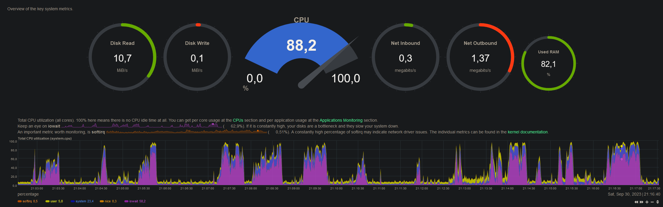

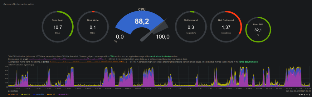

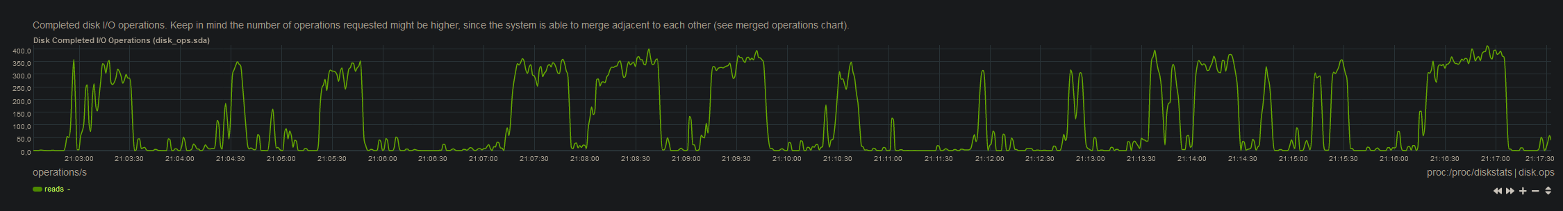

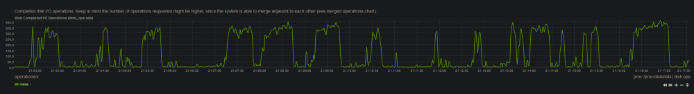

For me this is actually causing other applications to hang, as the CPU utilization caps out due to the amount of iowait on the system.
I use Netdata and have attached screenshots showing the CPU util (note the iowait) as well as the i/o for sda, which is my boot USB.
sda-util.thumb.png.61b772c5b791a4999557ccc58ca63979.pngcpu-util.thumb.png.568e9d6b07e9ab6186cf4251c81c7a11.png

syslog-192.168.31.10.log
Anyone could help me on this?
