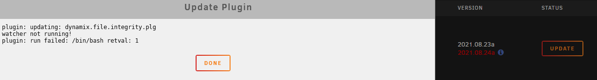

11 minutes ago, bastl said:
pressing the update button gives me the following error.
You caught me while upgrading the plugin. Didn't expect that.
There is now version 24a to rectify the installation error.
Hmm, something is not going right ... checking!
Edited by bonienl
@bonienl 24a gives me the same error
@bonienl 2021.08.24b fixed it.
Thanks!
I pulled the update, because it isn't working properly.
Please wait for a new update!
Please install latest version 24e. Thx

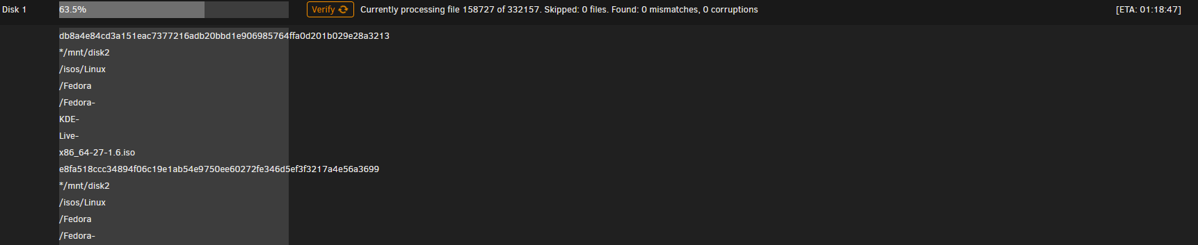

Short report for something weird happened to me. Planned verify task for 2 disks started this morning, 1 disk finished and reported a corruption on disk 2. Verify task on disk 1 still running. The coruppted file in my case was the nextcloud.log file getting flooded. I cleared the logfile, verify on disk 1 still running. I selected disk 2 and started a export task and the following happened in the ui
The ui shows as it looks like the full list of files beeing scanned on disk 1. Refreshing the page doesn't help. The counter for processed files is still counting up and constant read speeds on disk 1 showing that the process looks like it's still working. Only the page is messed up.
Please share your /tmp/*disk2* files and /var/tmp/*disk2* files. I did add errors to them, and it looks like there is at least on layout function which does not ignore this new content.
Is a disk2 process running? Because you should not see any disk2 stuff if no disk 2 process is running. After a process is finished, reload will remove your disk2 progress info.
Edited by Falcosc
@Falcosc I have no /tmp/disk2* files in that folder
and I can't really share the /var/tmp/disk2* filelist with you. I have a lot of personal and work content on that disk, some named with my real name or the name of the company I work for.  I can try to remove the personal stuff if it helps.
I guess not. On the main tab I only see reads happen on disk one where the verify process is still active. Looks like export for disk2 is already finished. Timestamp for disk2 is short after the time a started the process for a new export.
Yea, you can remove your personal stuff and save to see if the issue persists with your modified file
@Falcosc Maybe it helps to note that I am from germany and some of the files include the german letters Ää Öö Üü and ß for example
*/mnt/disk2/company/tmp/Präsentation/industrie-medium.png
also I have a folder where backups from my android phone are placed, some with the following naming included with an @ for example
*/mnt/disk2/nextcloud/user/files_versions/.SeedVaultAndroidBackup/1678426041580/kv/@pm@/Y2ibnQudnVXN1cn9tLZleQ.v1614280421
That is the reason why I would like to have the file. I test it once and didn't see any issue.
Edit it as much as you like. In the best case, you can reproduce the issue with just normal characters and only 3-5 lines in your .end file
Edited by Falcosc
@Falcosc Verify on disk 1 is finished. The file integrity control panel page still shows the the files from disk2 like in the screenshot of my fist post.
I have a lot of *.tmp.end files in /var/tmp and a disk2.tmp.end. Some are from august some from today. I renamed the disk2.tmp.end refreshed the page and disk2 export showed "canceled with error". Refreshed the page again. Error is gone. Started a new export of disk2. No errors. I'am kinda confused right now.
It could be possible that we still need a broken disk2.tmp.end file in case the bug is not obvious. (I worry that the bug is not obvious because at least one test run with simulated corruptions didn't have this issue)
