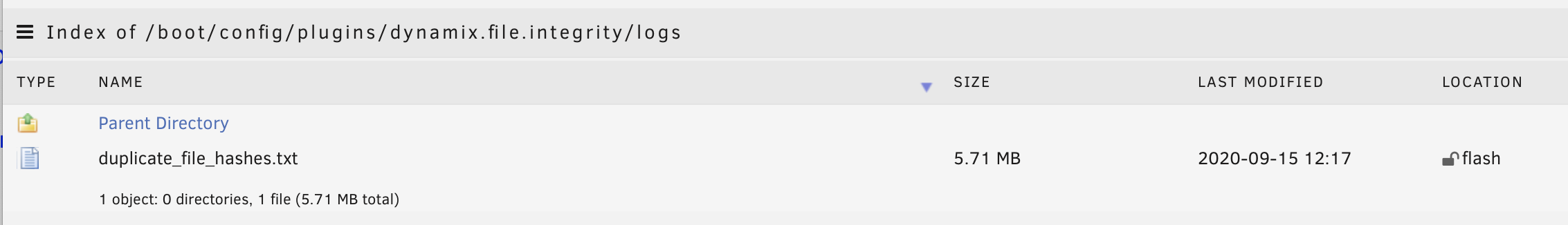

I received an unraid alert for "Found 1 file with SHA256 hash key corruption". How do I tell which file is corrupt? No log file was created. My last dynamix log file is from 2019. Thanks.
EDIT: I ran this cmd to find it, but surely there has to be a better way? Why is it not logging? "cat /var/log/syslog | grep corrupt"
Edited by pman

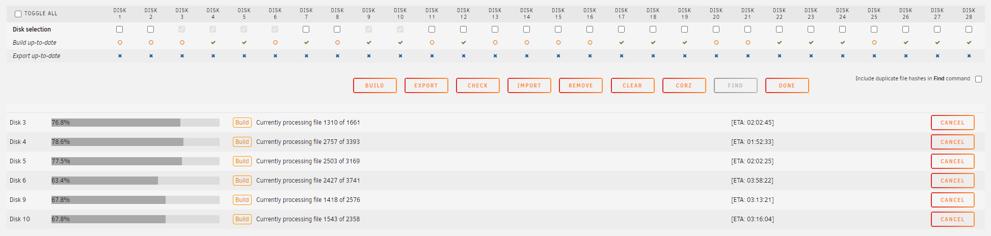

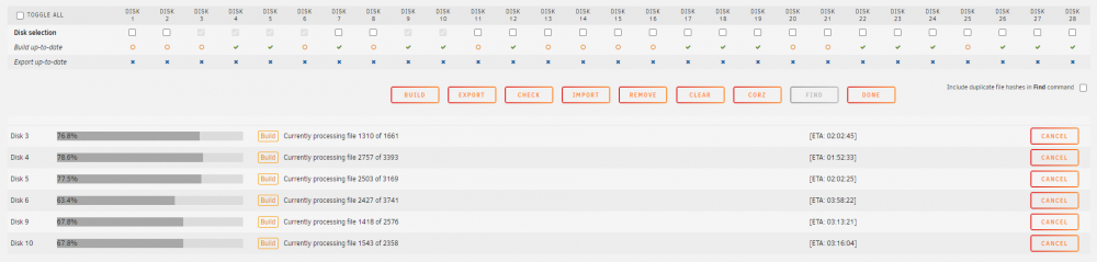

I've just installed and started using the File Integrity plugin today.
  • I manually started a `Build` process on 7 (out of 28) drives in my array
  • disk1 had least amount of files, so it has already finished
But, the UI shows some nonsense 🤔
  • it shows disk1 as a circle, not green checkmark, even though it has just finished the build, and is up-to-date
  • it shows disks 4, 5, 9 and 10 with a green checkmark, even though the builds are clearly still running and aren't finished
  • it shows disks 7, 12, 17, 18, 19, 22, 23, 24, 26, 27 and 28 with a green checkmark, even though the build process has never been run on these disk...
I mean, WAT? 😳
Can it be, that am I really not understanding what the circle/checkmark/cross means?
Or is this a bug?
