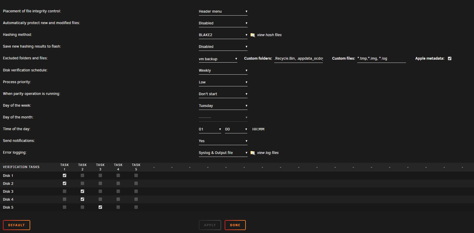

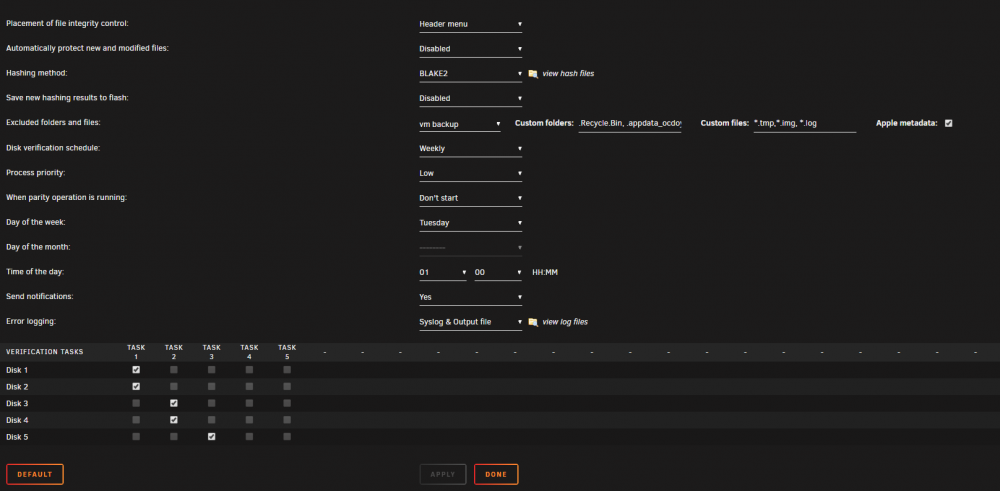

I've been trying to set up file integrity to get it to work but I'm not sure if I'm doing this correctly or not. I keep on getting BLAKE2 key mismatch on my libvirt.img and a lot of my nextcloud files: See example:
BLAKE2 hash key mismatch (updated), /mnt/disk1/nextcloud/.htaccess was modified
BLAKE2 hash key mismatch (updated), /mnt/disk1/nextcloud/appdata_ocdoy1vwt49l/appstore/apps.json was modified
BLAKE2 hash key mismatch (updated), /mnt/disk1/nextcloud/appdata_ocdoy1vwt49l/appstore/categories.json was modified
BLAKE2 hash key mismatch (updated), /mnt/disk1/nextcloud/appdata_ocdoy1vwt49l/appstore/future-apps.json was modified
BLAKE2 hash key mismatch (updated), /mnt/disk5/vm backup/libvirt.img was modified
Are these true errors?? I have these excluded and clearing it but every time integrity check runs it always finds these files mismatched.
Yeah, don't do that. The whole point of this plugin is to keep tabs on seldom used archival type files, files that should never change. Active files should not even be monitored, it's a waste of resources.
I understand and that's why I've added them on my exclude folders (as displayed on the screenshot) but it's still being monitored? I must be configuring something wrong but I'm not sure how I should fix it.
You need do clearing again and export, this to reflect the change.
