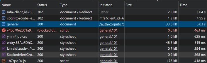

  1. Seems to me like every action to do with user auth is super slow on that website. Logging in, changing MFA or password, creating backup codes etc. Its not the case with other websites. Do other people have the same experience and know why? For example login, super slow:
