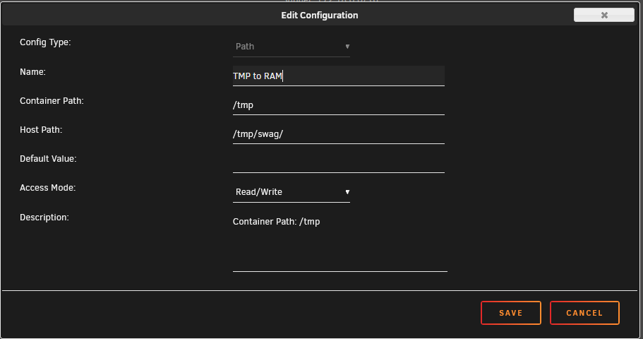

September 29, 20206 yr I've been trialling Nextcloud as a cloud backup service for myself, and if successful, my family which live remotely. I'm using Duplicati to perform the backups, but that's not the point of this guide. The point is that when I backup files to Nextcloud, the Docker Image slowly fills up. I've never had it reach a point where the Image reaches 100%, but it's probably not a fun time. After searching the internet for hours trying to find anything, I eventually figured out what was required. For context, I'm running Nextcloud behind a Reverse Proxy, for which I'm using Swag (Let's Encrypt). Through trial and error, the behaviour I observed is that when uploading files (via WebDAV in my case), they get put in the /tmp folder of Swag. Once they are fully uploaded, they are copied across to Nextcloud's /temp directory. Therefore, both paths need to be added as Bind mounts for this to work. What To Do Head over to the Docker tab, and edit Nextcloud and add a new Path variable: Name: Temp Container Path: /tmp Host Path: /mnt/user/appdata/nextcloud/temp Next edit the Swag (or Let's Encrypt) container, and add a new Path variable: Name: Temp Container Path: /var/lib/nginx/tmp Host Path: /mnt/user/appdata/swag/temp And that's it! Really simple fix, but no one seemed to have an answer. Now when I backup my files, the Docker image no longer fills up.
October 2, 20206 yr I have also experienced this exact issue and could resolve it also through mounting the above mentioned Paths. Only difference for me is that i have altered the Host Paths to the Unraid /tmp Dir so i am using the RAM and not the Cache drive for the Temp files. Therefore my writes on the cache drive are not as high. Host Path: /tmp/nextcloud/ and Host Path: /tmp/swag/
October 2, 20206 yr 4 hours ago, greenflash24 said: Only difference for me is that i have altered the Host Paths to the Unraid /tmp Dir so i am using the RAM and not the Cache drive for the Temp files. Be careful with this approach, it's easy to run out of RAM and cause bad results. Only do this if you have a very good handle on managing your server.

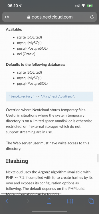

January 26, 20215 yr I feel like this temp directory must be set in Nextcloud config.php or none of this directory stuff above matters?
January 26, 20215 yr 17 minutes ago, TDA said: I've set it so: I'm talking about Nextcloud. And what does my command return? Changing tmp-paths of SWAG or NPM is not needed. Those are proxies which forward data and not saving it to disk (which would be extremely inefficient). If they would do that, they would be misconfigured.
January 26, 20215 yr 28 minutes ago, blaine07 said: I feel like this temp directory must be set in Nextcloud config.php or none of this directory stuff above matters? This could propably help. The problem is, that you have a tmp dir in the OS, a tmp dir in the webserver and a tmp dir in PHP. And finally as you mentioned, you could set a custom tmp dir for Nextcloud, too. So give it a try. Set the tmp dir through the config.php to "/tmp" and follow the step in the first post to map it to a different location like "/mnt/user/appdata/nextcloud/temp". If you want to map it to Unraids "/tmp" dir which is located in your servers RAM, you must create a tmpfs dir first as mentioned in this guide: https://forums.unraid.net/topic/35878-plex-guide-to-moving-transcoding-to-ram/page/12/?tab=comments#comment-894460 Otherwise it could totally fill up the RAM. So simply using "/mnt/user/appdata/nextcloud/temp" is easier. Mapping the Proxy Containers tmp dir is not needed as I explained before.
January 26, 20215 yr This could propably help. The problem is, that you have a tmp dir in the OS, a tmp dir in the webserver and a tmp dir in PHP. And finally as you mentioned, you could set a custom tmp dir for Nextcloud, too. So give it a try. Set the tmp dir through the config.php to "/tmp" and follow the step in the first post to map it to a different location like "/mnt/user/appdata/nextcloud/temp". If you want to map it to Unraids "/tmp" dir which is located in your servers RAM, you must create a tmpfs dir first as mentioned in this guide: https://forums.unraid.net/topic/35878-plex-guide-to-moving-transcoding-to-ram/page/12/?tab=comments#comment-894460 Otherwise it could totallly fill up the RAM. Mapping the Proxy Containers tmp dir is not needed as I explained before. I’ll have to play with it later today. Makes sense I’m my head; what you’re saying.
January 26, 20215 yr 2 hours ago, mgutt said: This could propably help. The problem is, that you have a tmp dir in the OS, a tmp dir in the webserver and a tmp dir in PHP. And finally as you mentioned, you could set a custom tmp dir for Nextcloud, too. So give it a try. Set the tmp dir through the config.php to "/tmp" and follow the step in the first post to map it to a different location like "/mnt/user/appdata/nextcloud/temp". If you want to map it to Unraids "/tmp" dir which is located in your servers RAM, you must create a tmpfs dir first as mentioned in this guide: https://forums.unraid.net/topic/35878-plex-guide-to-moving-transcoding-to-ram/page/12/?tab=comments#comment-894460 Otherwise it could totally fill up the RAM. So simply using "/mnt/user/appdata/nextcloud/temp" is easier. Mapping the Proxy Containers tmp dir is not needed as I explained before. I will try later - but I've set NEXTCLOUD to go to the TEMP because I want it in the ram, not on my slow disks. And I don't plan to upload a 100GB File - so I can't really fill up my ram with an upload.
