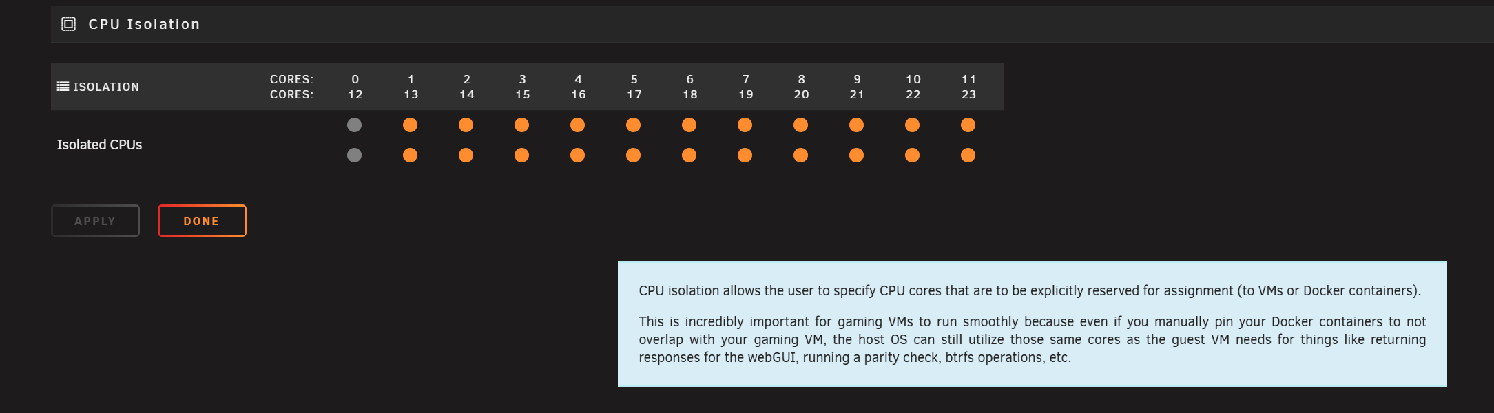

  1. It seems better in the way I configured it, but still problem when JDownloader extract rars. The CPU spikes to 100% till isn't finished. I also tried to allocate 4specific CPUs to the docker, but it doesn't make any difference.
  2. Made the setting you suggested, and it seems that with this configuration - if you don't explicitly set the CPU PIN, only the 0-1 is used. But according to the "help" Meaning (from my understanding) if you isolate the CPUs apart of the one of the I want to be used by Unraid has the effect, that ALL is using only the unpinned CPUs. Meaning, all dockers with unpinned CPUs are using the 0. Which is exactly the opposite I wanted, so I think I have to try the other way around (selecting only the 0-12 in my case).
  3. Hello, Since I don't have pinned any Docker till now (and VM are explicitly setup to NOT use the core0+HV) I think I'll try it and get back to you in a few days :-) Thanks for the hint! P.S: Is this the best practices to let Unraid use his preferred CPU? (so the 0 ? ) AFAIK - if unraid need more CPUs, it will in any case use what he needs. But not the other way around with your suggestion right?
  4. Hello Everyone, I wanted to ask if is there a setting, where you can isolate core0 to be exclusively used by UnRaid, without having to configure every docker and VM to use specific cores, since when core0 hits 100% the whole thing is stuck. It would be if it would be possible to just exclude the core0. Thanks for any advice.

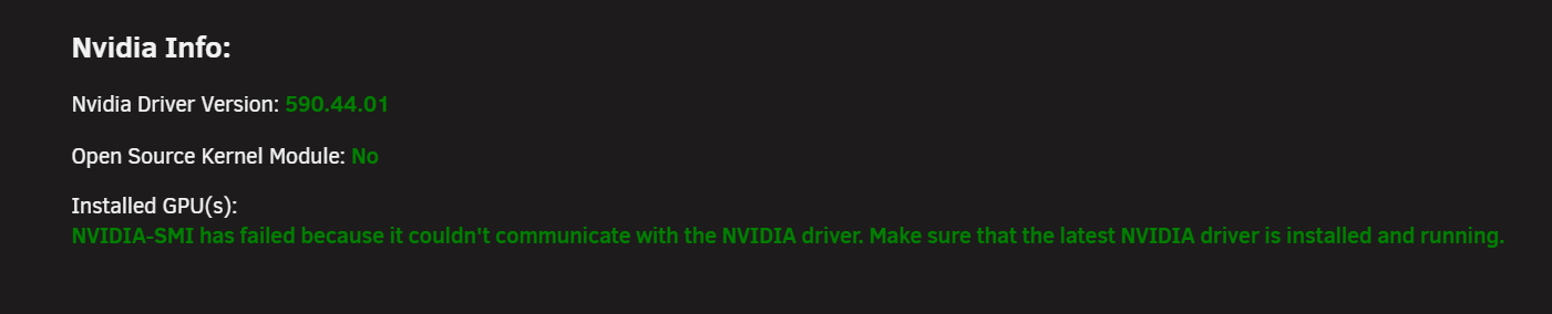

  5. Hello everyone, I'm having an issue with the latest driver version: I tried to revert back to the older version, which was running (580.105.08), and my TeslaP4 is back up and running. Is there some problem with the latest driver or what?

  10. Hello Everyone, I've a recurrent problem since using Unraid (I started like 5years ago). As soon as some of the CPUs hits 100% (mostly due to either unzipping or SMB transfer), the whole server freezes: I don't know if I've missed some setting. Is also strange that only a couple of cores are so busy when extracting a .rar/.zip for example (which normally happens trough a Docker container / JDownloader) Any advice is appreciated.
