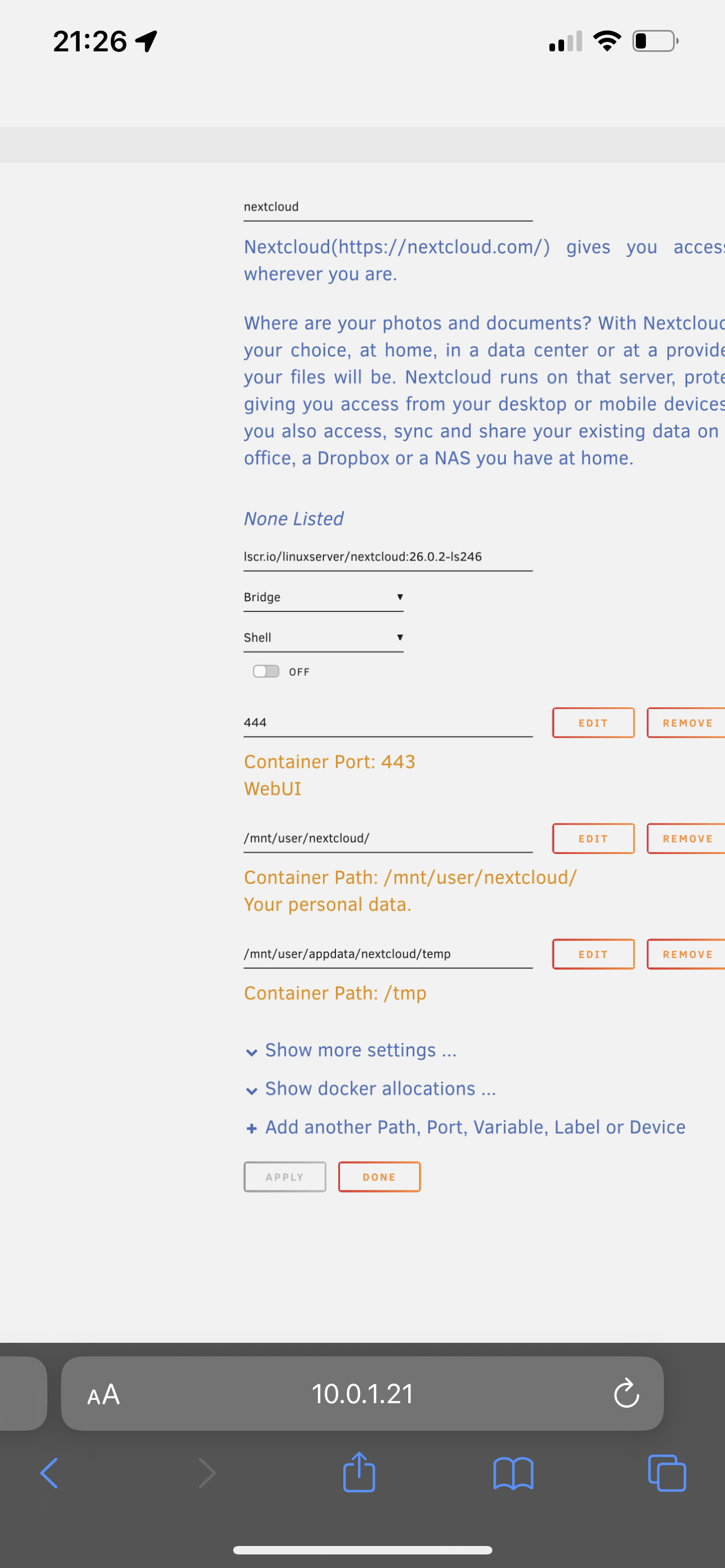

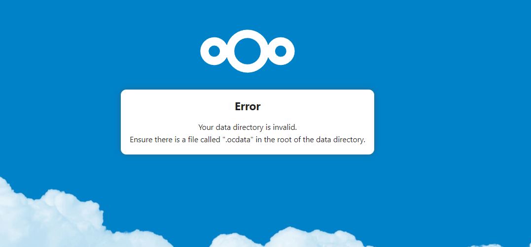

July 22, 20233 yr On 1/26/2021 at 6:17 AM, mgutt said: Did you set "/mnt/user/appdata/nextcloud/temp"? If yes, are there any files in this folder when you upload files? Alternatively upload your file and execute this command through the Webterminal: find /var/lib/docker -type f -printf "%T@ %p\n" | sort -n | cut -d' ' -f 2- | tail -n 50 It shows you the 50 most recent files in the docker.img. I added the temp path now my nextcloud return the error .ocdata. what should i do? thanks
July 23, 20233 yr From what I can see in the template your data mount should point to /data in the container but you've somehow changed it to /mnt/user/data
