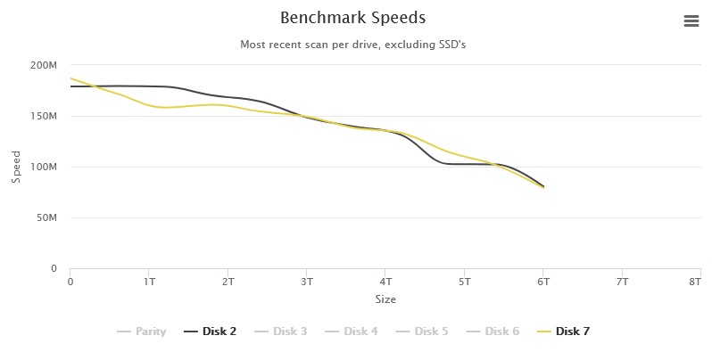

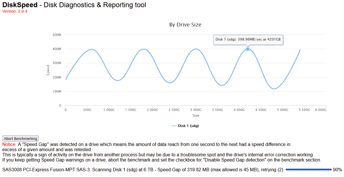

  2. I've suspected that this is somehow connected with SMR. The weird HDD is only 44% full, but two other drives are 76% and 65% full respectively, so they produce normal graphs: So, are you saying that I can expect normal result if I fill my HDD over 50% or more? In this case DiskSpeed will need some tweaking, I suppose, because speed gap doesn't increase on retries and disabling it doesn't work either for some reason. First I thought that my HDD was faulty, but now I'm thinking that WD SMR technologies mess benchmarks up.

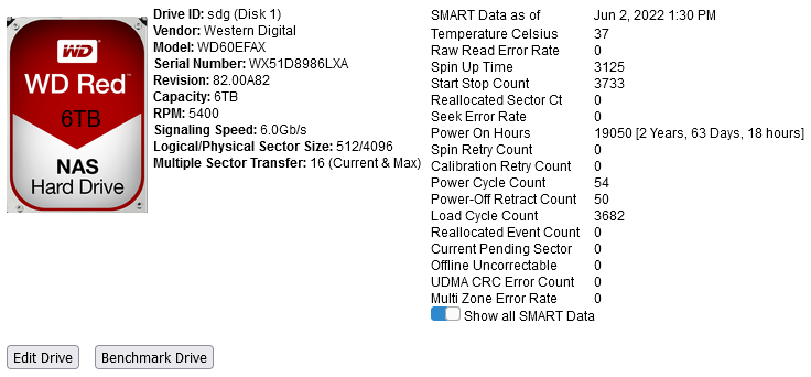

  3. Thanks for this essential tool. I strongly feel that SMART is not (has never been?) reliable enough for reporting true HDD health status. I've benchmarked my HDDs and now I'm puzzled with this result: I didn't find similar results in this thread. How such high speeds are even possible? What does this 'sine' behavior say? Also, max allowed speed gap doesn't increase after 25+ retries, so I had to just abort this benchmark. Benchmarks of two other similar HDDs don't report anything unusual. This is SMART of the weird one:
