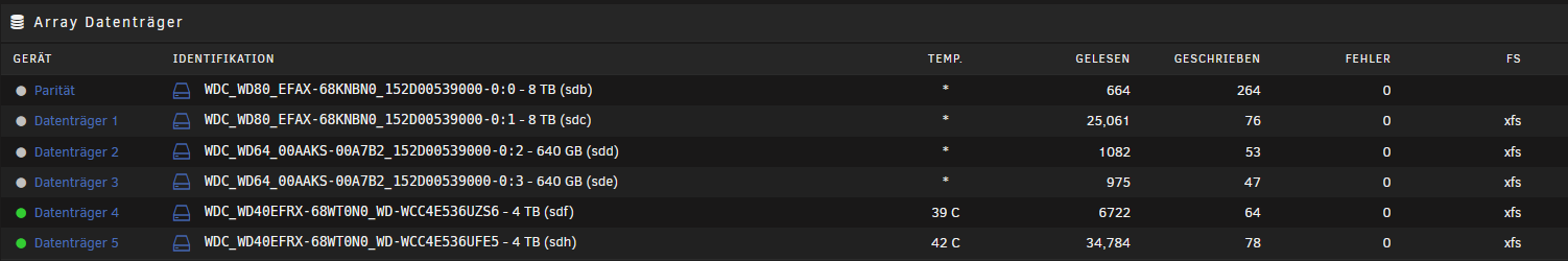

I'm using a small server with an external 4-bay USB 3.0 storage device from Fantec. It is connected by USB 3.0 and I have 4 WD Red in that case.
Additionally 2 WD Red + 1 SSD in the server case connected via S-ATA.
Since UNRaid 6.9.0 RC2 the disks in the external case were not detected corretly. If the drives spin-up because of an access, UNRaid doesn't notice that. I got no SMART values. And because of that they won't spin-down correctly, because UNRaid doesn't know that they're up. But if I spin them up manually everything is working fine. They spin down after 30 min and I get the values.
Every drive on the screenshot should be green, because they're running.
I hope, that someony has an idea what I can do.
