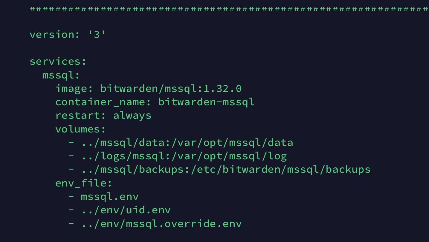

Now in my case Bitwarden is using Docker Compose to build the Bitwarden environment, so I had to tweak the yml code.
The default docker-compose.yml (located in bwdata/docker) lists the following lines for the mssql container:
version: '3'
services:
  mssql:
    image: bitwarden/mssql:1.32.0
    container_name: bitwarden-mssql
    restart: always
    volumes:
      - ../mssql/data:/var/opt/mssql/data
      - ../logs/mssql:/var/opt/mssql/log
      - ../mssql/backups:/etc/bitwarden/mssql/backups
    env_file:
      - mssql.env
      - ../env/uid.env
      - ../env/mssql.override.env
Now if we create an override file named docker-compose.override.yml and also place it in the same bwdata/docker directory we only have to put these lines in:

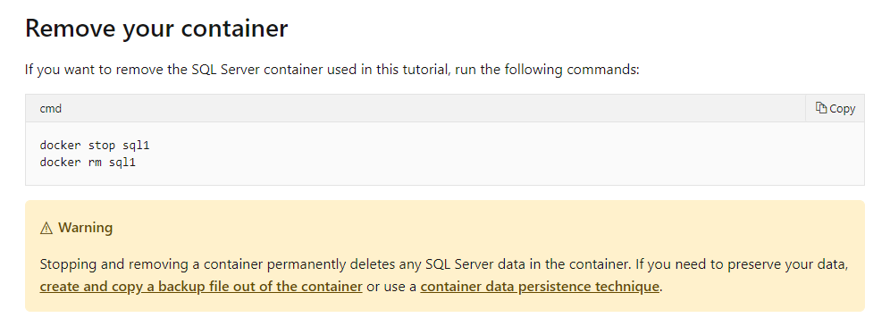

The Microsoft article actually describes this behavior:
The link describing data persistence point you to the -v options, which is what adding a path lets DockerMan feed docker under the hood.
Running docker pull bypasses DockerMan so it'll show up as an orphaned container when it's off.

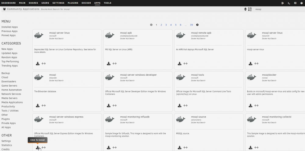

That is essentially the Add/Edit Container page in the Unraid webUI, as seen in @S1dney screenshot in the previous post. It is a form for entering all the things that you would need to put into a docker run or docker create command. When you submit the form, it is saved as a template on flash for you to reuse, and the docker run command with all the items on the form is executed. And once you have that template, you can work with it just like any other docker in Unraid.
1 hour ago, jowi said:
I did not use a sql server docker from (someone else's) docker hub, i got it directly from microsoft using:
docker pull mcr.microsoft.com/mssql/server:2019-GA-ubuntu-16.04
and installed it according the instructions on https://docs.microsoft.com/en-us/sql/linux/quickstart-install-connect-docker?view=sql-server-linux-ver15&pivots=cs1-cmd so i got a 'bare metal' docker running in which does show up in UNRAID's docker tab but i can NOT change ANYTHING from the unraid docker tab.

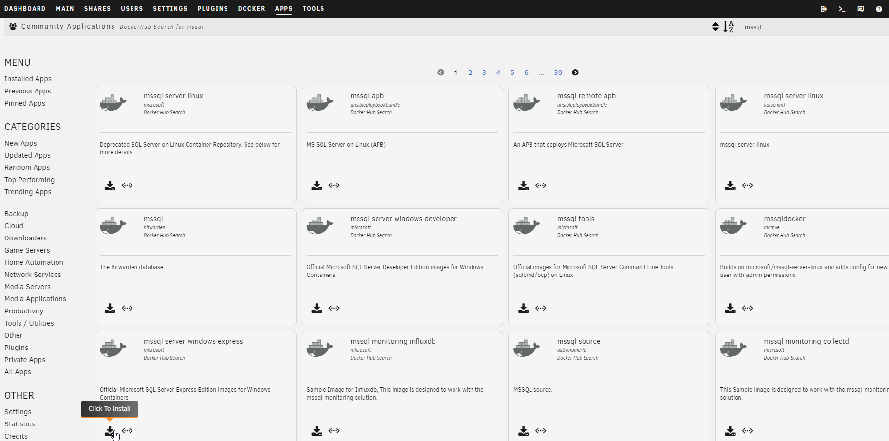

The one in the screenshot is actually the docker from Microsoft's official docker hub:
(Expand the search to DockerHub)

Tested the one from the screenshot, but it gives an error (Error: image operating system "windows" cannot be used on this platform). Looks like it is a docker built on windows not on linux? Also unknown what version etc. and passwords... it is all ment well i guess but i'm not gonna try 40 (!) pages of mssql dockers that people created mostly for their own use. I will go try a few, but this is not what you want... i tested another one and looked at the dockerhub page for info on passwords etc, it was there but nothing works... so unless i get lucky i think i still need to make my own docker container?
Edited by jowi
I think you're right on this one.
I only picked that container as an example.
According to the Community Apps GitHub, the Apps page does a lookup to the Docker Hub with this command:
shell_exec("curl -s -X GET 'https://registry.hub.docker.com/v1/search?q=$filter&page=$pageNumber'");
I first noticed that the Apps searchbar filters special character so I thought I try to hack the URL itself:
Somthing like:
   - 'https://registry.hub.docker.com/v1/search?q=mcr.microsoft.com'
   - 'https://registry.hub.docker.com/v1/search?q=mssql/server'
Tried all kinds of variations but nothing works.

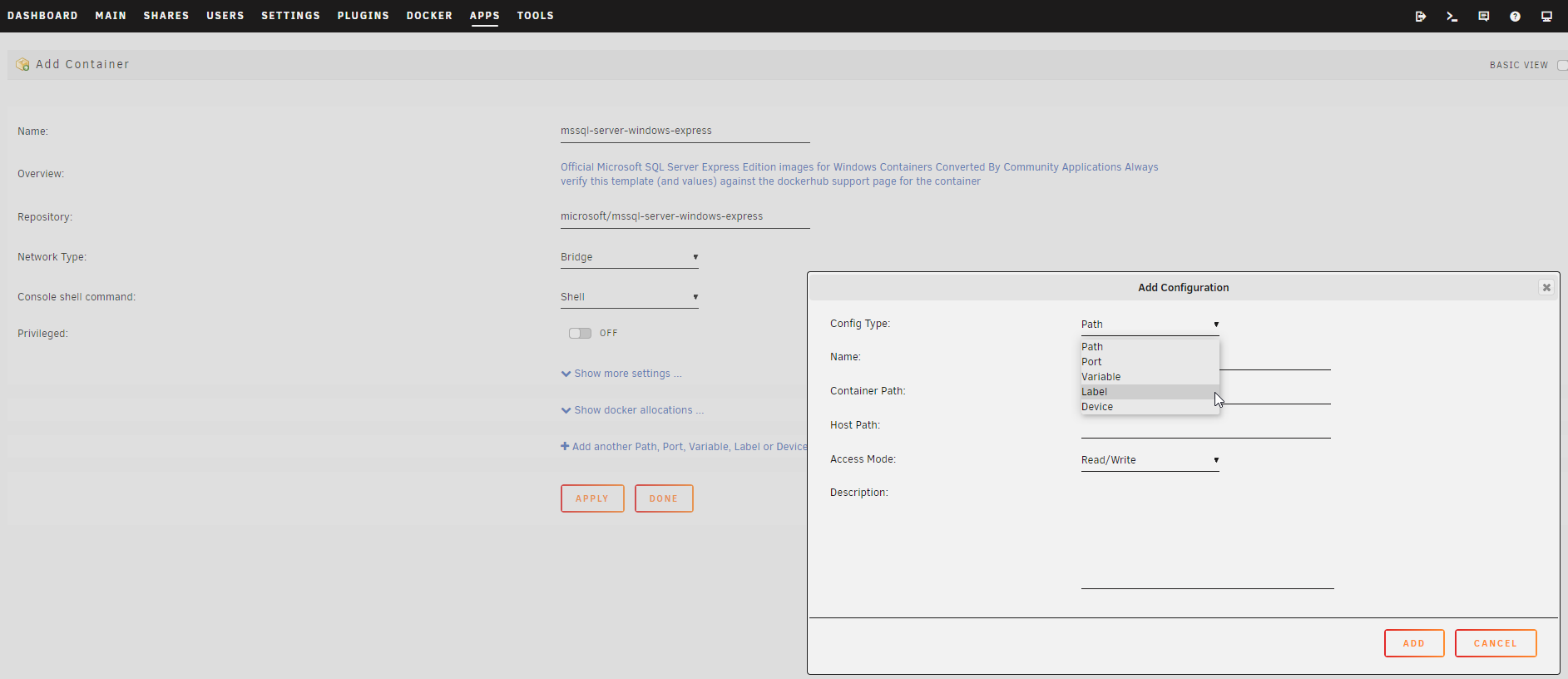

Download an official image you CAN download, I've downloaded pihole/pihole for example.
This gives you a template to work with:
cat /boot/config/plugins/dockerMan/templates-user/my-pihole.xml
You can copy it and modify the values you need.
After all settings are changed you can deploy the template from the docker tab -> Add Container -> User-Templates.
I've created a short MSSQL image briefly using this template below and it pulls the image just fine:

When you deploy your container from this image you can modify all other settings (such a paths and ports) from the DockerMan GUI, which is a lot easier.
Note that this will also save the changes to the template so this appears to be a one time action ;)
