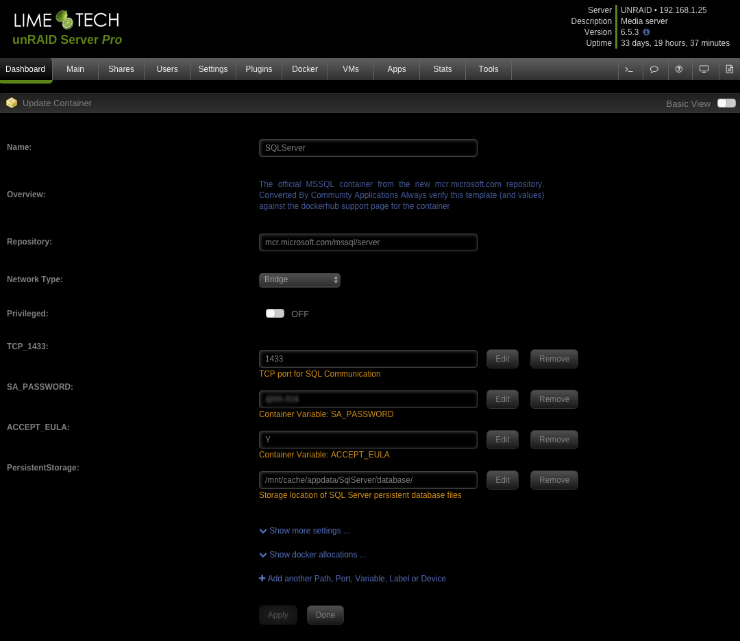

26 minutes ago, jowi said:
After removing the docker and re-installing it, all seems to be ok. Path is now also showing, so i think i'm good. For completeness and for others, here are the settings and the xml.
DUDE, it works!
What's the difference from what I was doing?  I made it all manually using your settings, maybe that was it.  I also noted that the path has a trailing / - which I don't think I had before?  Not sure if that makes any difference.
The only thing it doesn't do is grab the icon, not sure why

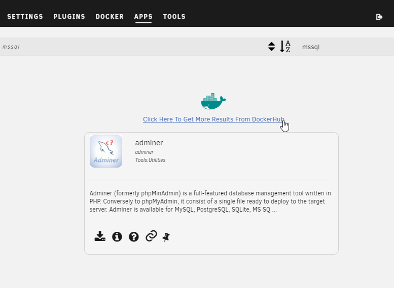

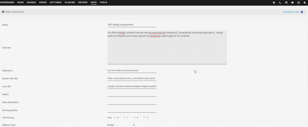

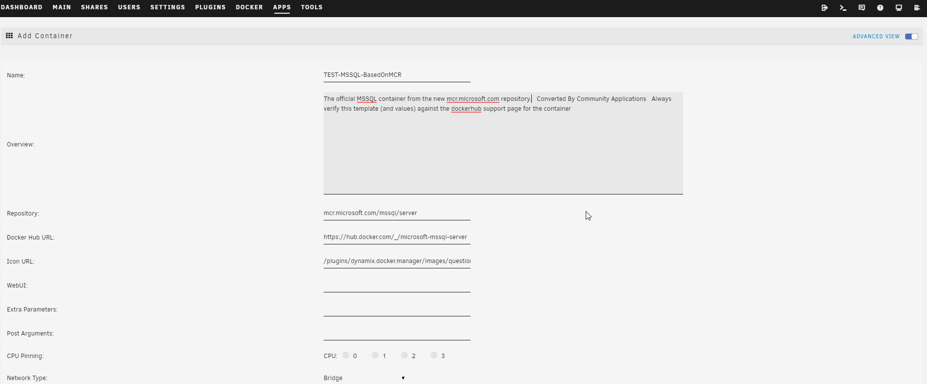

Now @BoxOfSnoo's comment got me thinking.
Modifying the user-template can be done more easily then copying the XML files on the flashdrive via the command line.
So in case anyone else wants to download the image from the new Microsoft Container Repository I would take these steps:

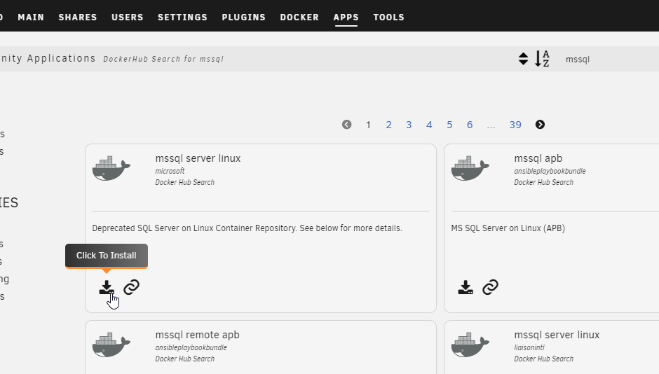

Search for mssql in the Community Apps (make sure that searching the DockerHub is enabled in the settings).
And click "Click Here To Get More Results From DockerHub".

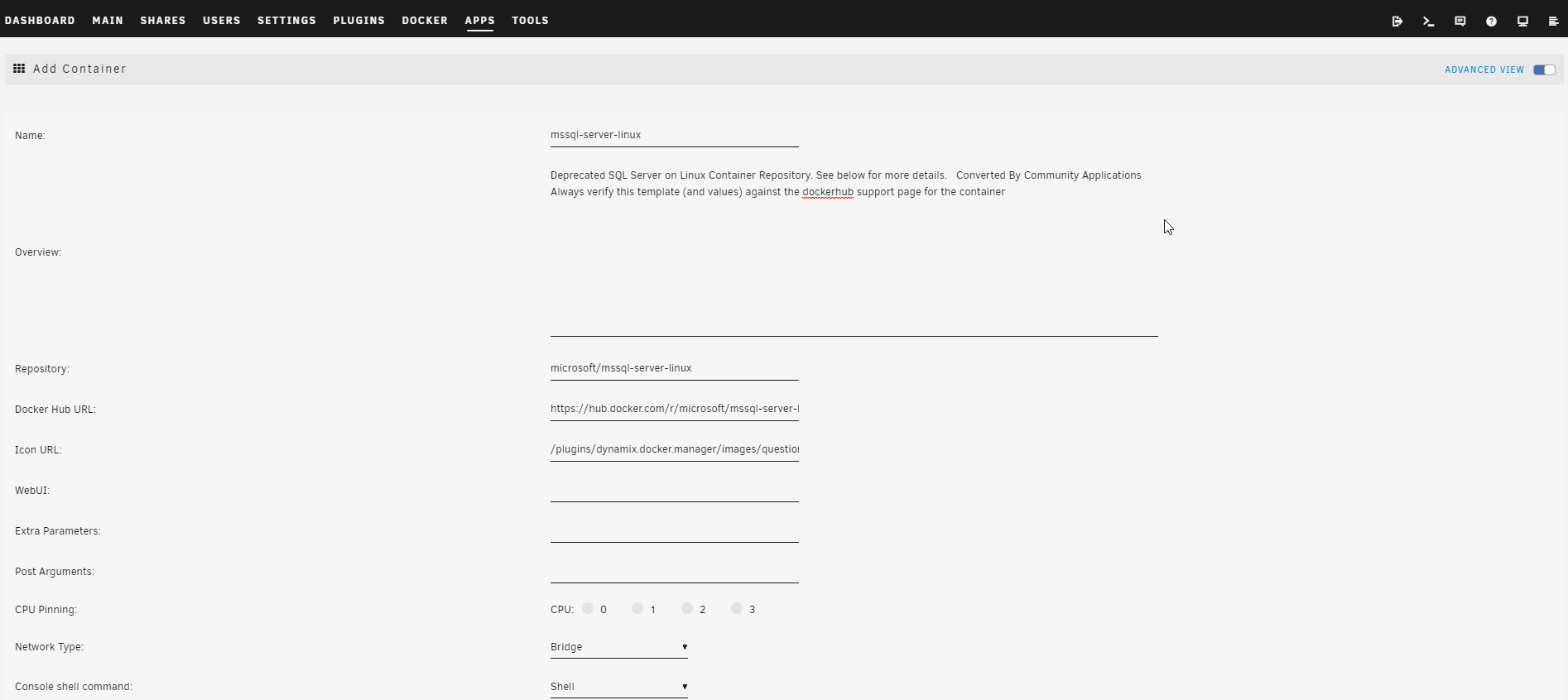

Install the mssql server linux container (allthough it can be any container of choice, doesn't has to be mssql either)
Make sure "Advanced" view is selected, this will show you which Repository and Docker Hub URL you're downloading the image.
Change the following values:
Name: Name of your container obviously
Repository: mcr.microsoft.com/mssql/server
Docker Hub URL: https://hub.docker.com/_/microsoft-mssql-server
Icon URL: If you want a custom icon.
Description: To something descriptive (although not really necessary).
Then add the required Ports, Paths and Variables from the GUI.
After clicking Apply the docker is created from the new Microsoft Repository and the template is written to Flash, without even using the command line.
In my case it wrote (my-TEST-MSSQL-BasedOnMCR.xml to /boot/config/plugins/dockerMan/templates-user/).
Easier then messing around with XML's from flash ;)

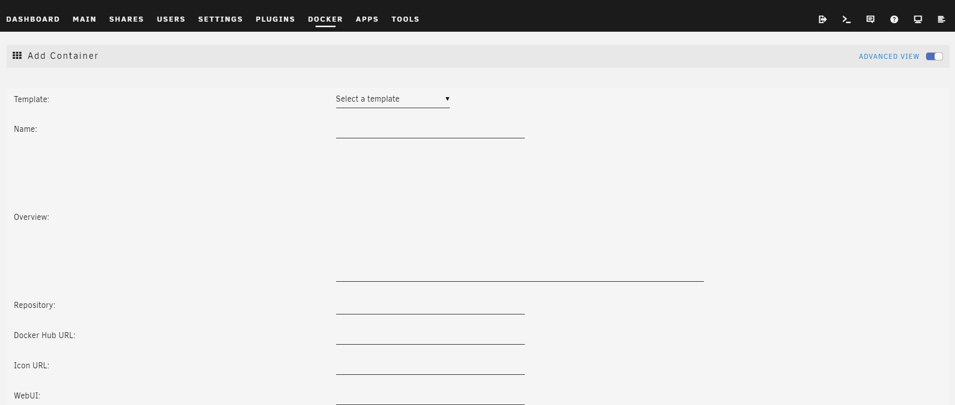

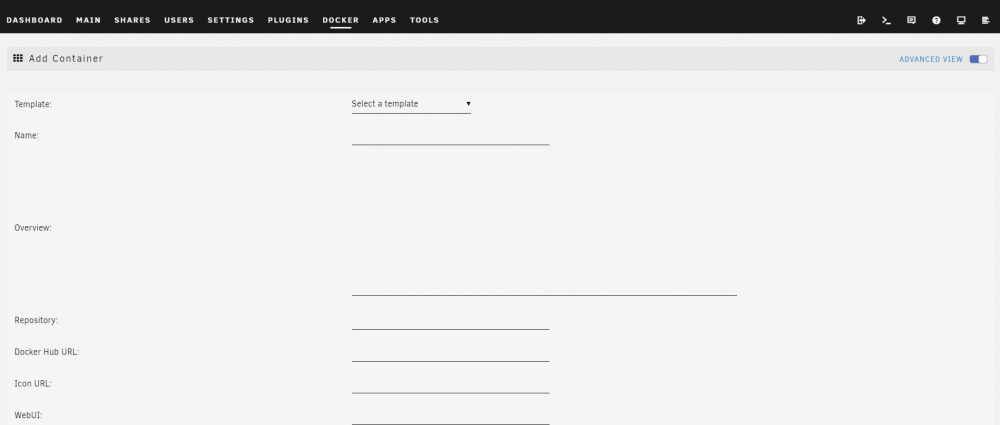

EDIT:
Downloading a new container isn't even necessary, as you can just click "Add Container" from the docker tab.
Just making sure the "Advanced" button is selected gives you the exact same options.

32 minutes ago, trurl said:
Not a stupid question at all.
Here is the Docker FAQ post about that:
https://forums.unraid.net/topic/57181-docker-faq/#comment-566084
As mentioned there you should also create a support thread where you can support it.
Hahaha saw this after I hit apply.
Thanks, I will also check it out!
Until the time some developer wants to take ownership of publishing the MSSQL container, my way described above also works I guess :D
Edited by S1dney

On second thought you're right.
I know that DockerMan/GUI is the way to interact with docker on unRAID, but I didn't know (yet) how to pull a docker container that could not be located from the Apps (or DockerHub within Apps) section.
Therefore I thought to include it if anyone end up here with the same questions.
I've edited my post cause adding a container from scratch using "Add container" might even be better, this is the way it's meant to be used I guess 😅, I always found any container in the Apps or DockerHub section so never had the need to look into this more.
Thanks for time taken to elaborate/help though :)

Yes, I'm on rc7.  I built mine using "Add Container" and plugging in the values as recommended above.
