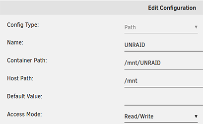

For other Docker installations, an example is -v '/mnt':'/mnt/Host':'rw' if you have all your SSD's mounted under /mnt. You may need more than one volume parameter if they are mounted in different areas.

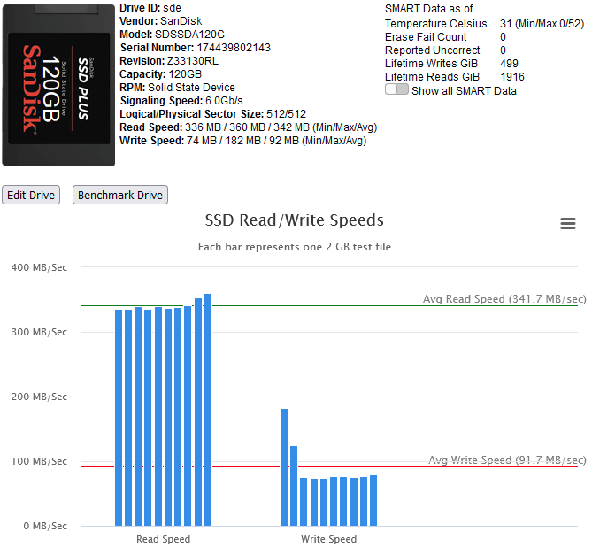

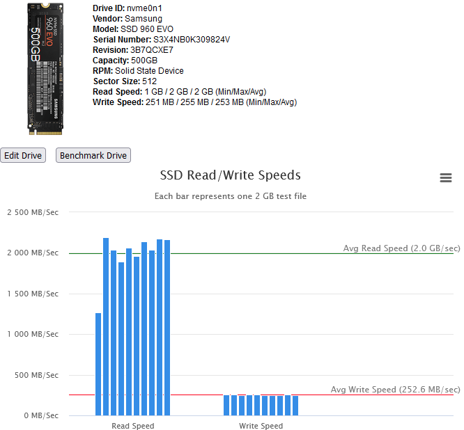

  • Right Proper SSD benchmarking has been added. To perform a benchmark, a configurable number of test files of a given size (defaults to 10 2GB files) are written to the drive and then read back. The ov

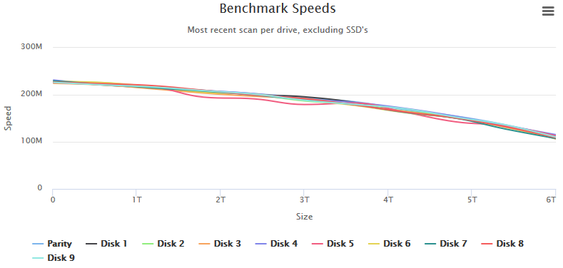

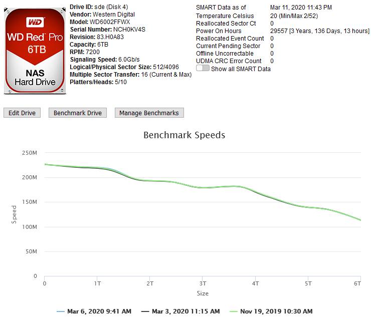

When I tested this utility against my production server, I noticed that I had a drive going wonky on me. I couldn't even test it at first because it kept tripping the SpeedGap detection in which the minimum & maximum speed over 15 seconds was too great - a sign of disk activity or in my case, a drive giving very inconsistent read speeds. I had to add logic to disable the SpeedGap detection to even be able to fully test the drive.
In this case, the drives are all the same make & revision and their curve should be nearly identical but Disk 5 stands out.
Viewing Drive 5 by itself, I can see it's curve is not normal. Spinners should have a steady decline over the entire range of the drive. I'll be retiring this drive from my main server and using it for platter heat map test where the entire drive is read and a heatmap of the read speeds given.
Edited by jbartlett

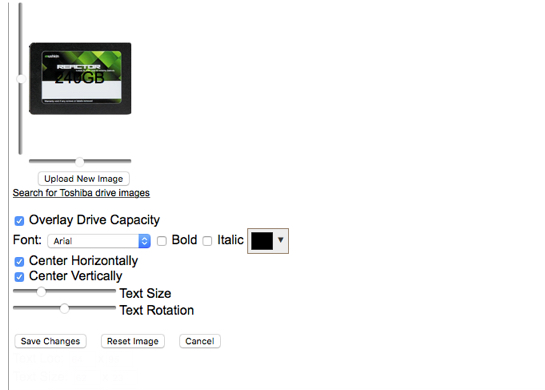

Also, i see that my Mushkin MKNSSDRE240GB-LT SSD seems have been improperly identified as a Toshiba drive.
I added the image manually from your database.
Edited by wgstarks

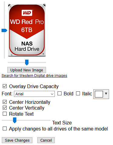

WD80EMAZ was missing from the database as far as I could see. I uploaded a cropped image I stole off the internet.
That seems to be the case for all Mushkin drives. I added logic to beta 2a (pushed) to change the Vendor to Mushkin if the model starts with MKN.
All of the images came from the same source ;) Though some vendors were nice enough to have presentation media to use.
After updating to beta 2a I see that changes that I made to the drive capacity display aren’t being saved. Would it be possible to save these changes across docker updates?
Also, the Mushkin is now detected correctly. Thanks.

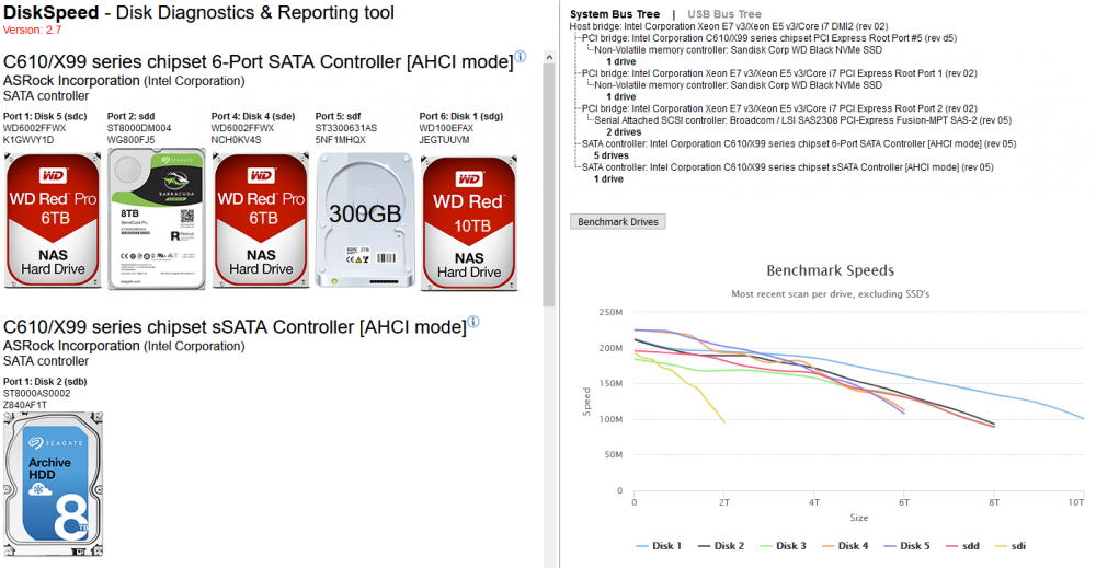

Not seeing the drives on my Areca controller.
ARC-1280/1280ML 24-Port PCI-Express to SATA II RAID Controller
Areca Technology Corp.
RAID bus controller
No drives detected
Current Link Speed: 2.5GT/s width x8 (2 GB/s max throughput)
Maximum Link Speed: 2.5GT/s width x8 (2 GB/s max throughput)
Bus: 32 bits @ 33MHz
Driver: arcmsr
Capabilities: storage pm msi pciexpress bus_master cap_list rom
ps. just noticed it misidentifying the model number. I have Areca ARC-1231ML

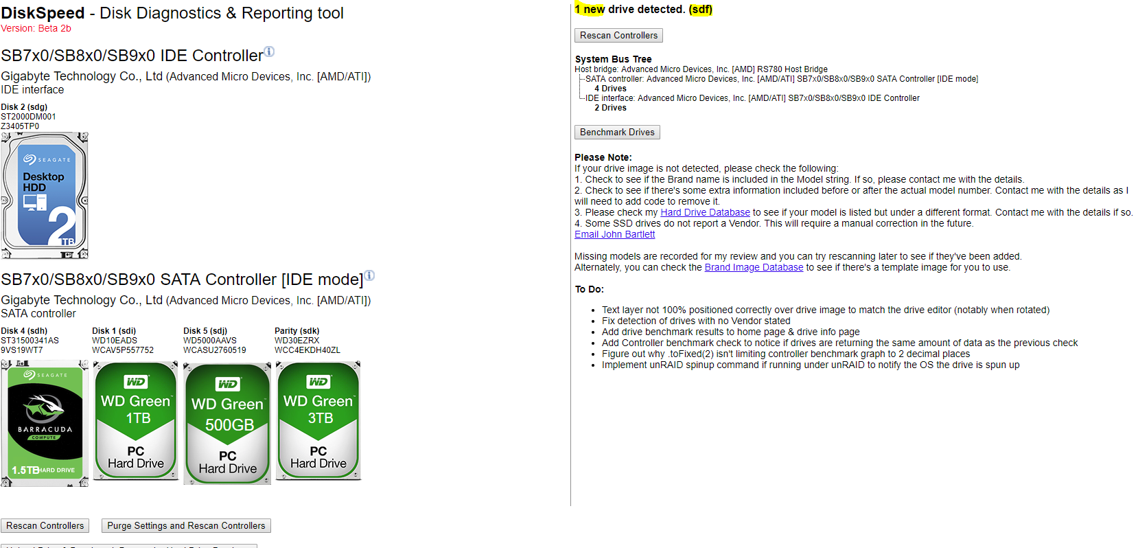

Installed
this is what I have.
and this is what is "found" even after re-scans.
Missing a few drives there. (3 total)
1 3tb WD
1 2TB WD
1 5TB Seagate
any advice?
Do you have a 3rd controller that the three missing drives are attached to? If so, what is it?
Not that I am aware of.
14 SATA connectors on the Motherboard is all I have. I think its split up in 10 and then 4

I have a similar issue in that one of my drives is not shown but the other 5 are. Also on the right is says 1 new drive detected (SDF) which is also the one not shown.
Onboard SATA controllers aren't being detected. I'll add code to pack up the saved data files so I can see exactly what you see and troubleshoot.
