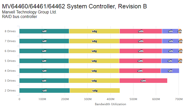

39 minutes ago, papnikol said:
There is more bandwidth due to the move from PCI e 1.0 to PCIe 2.x. But still, the bandwidth is not balanced across all disks. The bandwidth usage is maximized for each drive until the last 2-3 drives have very little bandwidth available.
I'm seeing the same using the SASLP, looks like some issue with diskspeed and this specific controller, real world bandwidth of the SASLP is around 640MB/s, so just divide that by the number of disks you have connected and it will be max speed during check/rebuild.
What the app does is to start a balls-to-the-wall read of each drive using dd (to null) with the progress & cache bypass switches as  background tasks running simultaneously. After 15 seconds, it kills the pids of the background processes and then analyzes the log files. To the OS, it should look like x number of applications requesting disk data. This is different from unRAID because unRAID will read one block from each drive, check, read the next block, check that block, repeat - the drives should naturally balance out the reads as unRAID is (likely) self-throttling.
I'm not sure how I can work around this.

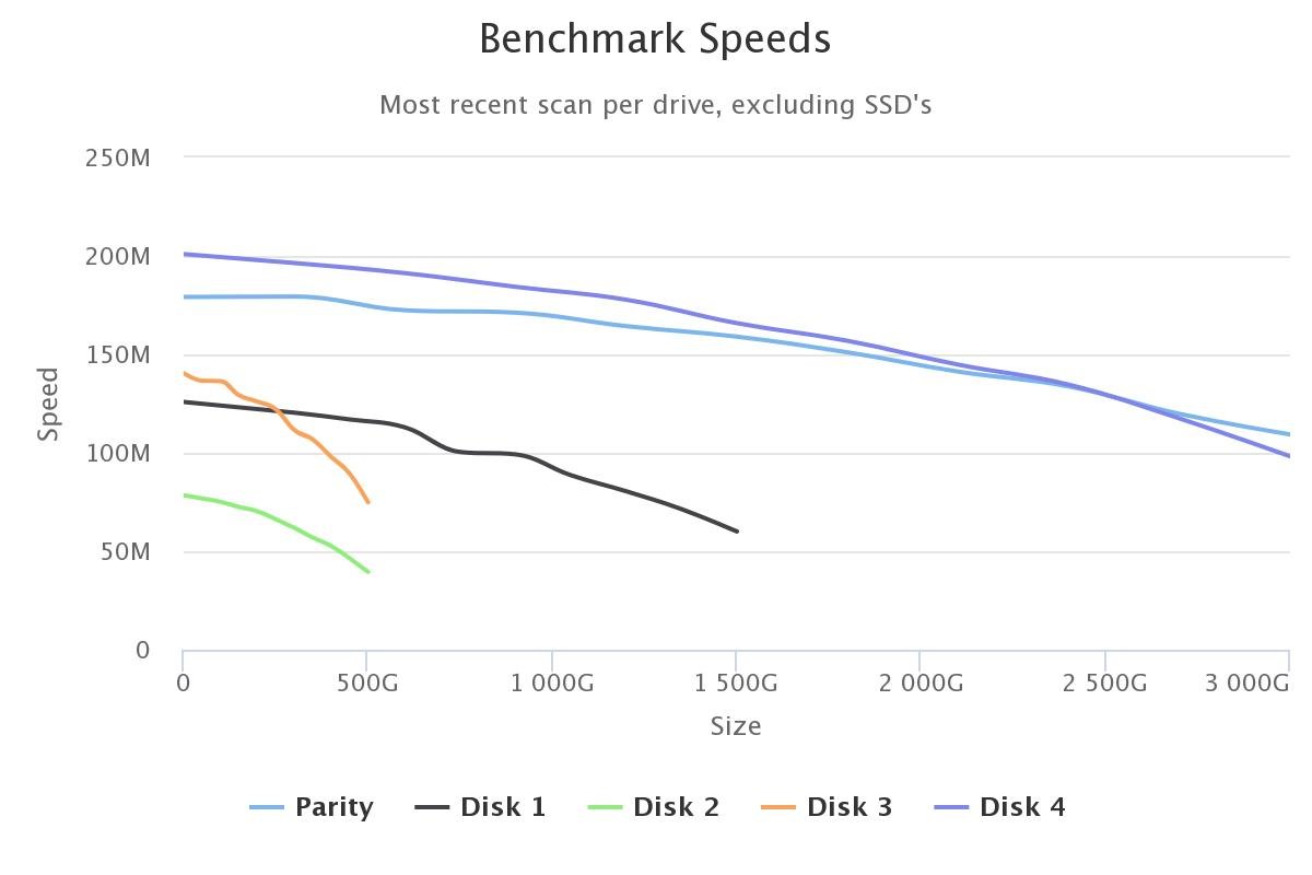

How does mine look? I know I need to replace those old 500GB drives but I am waiting to move out :-).
