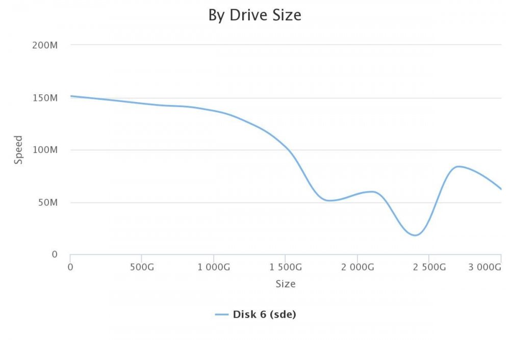

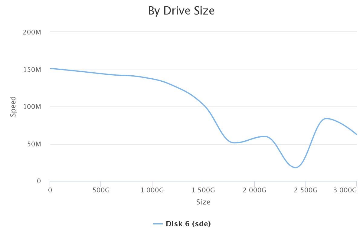

I just ran diskspeed and got the following result.  I have three WD30EZRX drives. Two of them (disk2 and disk4) behave normally and virtually identically.  But disk6 is weird.  What could cause the massive dip at 2.5 TB?  Have you seen this behavior before?  Should I replace it?
See if the result is repeatable. If something was attempting to access the drive at the same exact time the benchmark tried to run it could cause that kind of result.
Unfortunately, it seems very repeatable.  Also, I had to disable the Speedgap detection to get it to finish at all.
Checked the SMART values and these stand out:
9    Power on hours    0x0032    051    051    000    Old age    Always    Never    35911 (4y, 1m, 4d, 7h)
197    Current pending sector    0x0032    200    200    000    Old age    Always    Never    2
Drive was put into service May 2014.  Could the speed drop be explained by the current pending sector count?
Not always directly correlated, but since the drive is showing current pending, and you are seeing the drastic drop in performance, I'd say it's time to retire the drive from array duty.
Both together gives me a very bad feeling about the drive. It's not a very good feeling to have a known bad drive, and suddenly a drive you had no warning goes bad and you have to cross your fingers and hope the iffy drive survives long enough to recreate the failed one. I would rather proactively replace than limp along and hope.
The SpeedGap logic detects drive activity by comparing the min & max read speeds. If the difference exceeded the threshold, it increases the threshold a little bit and then retests it. If you were getting wildly varying results, that would explain why you had to disable it to even finish the drive. It looks like there's a LOT of coverage that's giving varying read issues.
Kick off a benchmark from the main screen and select the drive in question and another drive on the same controller but do not disable the SpeedGap logic. When the benchmark starts, you'll see the following under the graphs: "Click on a drive label to hide or show it." - the period at the end is a hidden mouse click trigger to unhide the iframes that are running the tests. It'll let you see what the SpeedGap detection is finding.
My next project with DiskSpeed will be handy here. Do a full read of the entire drive and graph out on a heat map the amount of data each section reads in 1 second.
For example, I start a balls-to-the-wall read of the drive using dd with progress tracking being logged. It reports how many bytes it read each second with the read speed. The number of sectors those blocks will hold the read speed for that second. Then repeat for the next second - and so on. I'll likely do an "overhead" scan where it reads a couple seconds worth over with big gaps in between, like every GB or 100GB, then go through and fill it in.
Also trying to programmatically determine how many platters & read heads a drive has. That one has been very elusive. I've tried about five different methods to try to get timings, got one more left to try before calling it quits and using crowd sourcing for populating. Last method to try would be to read the first two sectors of the drive, then move forward one sector and read two, then moving it back one more sector, and continuing until I've stepped over 20 sectors reading two sectors at each spot. Each of these two sector read will be repeated 200 times and the read speed averaged. The thought is that when the sectors are on the same track, they'll give nearly identical speeds but when the sectors span a track requiring the drive head to move, there will be a slight bump. A single platter drive may reveal a spike when reading sectors 1 & 2 (first sector = 0), a dual platter drive with four heads would show a spike at sectors 3 & 4 where a dual platter with 3 heads would show a spike on 2 & 3. *crosses fingers*
Hard drives reads all heads on a given track in sequence so if you read 4k of data with 512 byte sectors, it'll read track 0, heads 0-3 in sequence to give you the first 2k of data, then move the drive's head to track 1 and read heads 0-3 again for the next 2k of data.
Rats. Doesn't look like that worked either, even averaging 400 tests and also going from the end of the drive forward, the timings just aren't accurate enough.
Hmm.  Here is what I found about "Current Pending Sector Count" (damn, I just hear that in Siri's voice :-)
"Count of "unstable" sectors (waiting to be remapped, because of unrecoverable read errors)."
If the reads of these sector have unrecoverable errors, haven't I lost data already?
Or is it that the read error trigger a seek to a different track and that would explain the sudden drop in read data rate?
Anyway, I decided to remove the drive.  I just installed a new 8TB drive shucked from a WD My Book so I have lots of extra space.  I just wish there were a less nerve-racking way to move the data from disk to disk.  I use rsync but I am never completely convinced that every single bit is copied.
