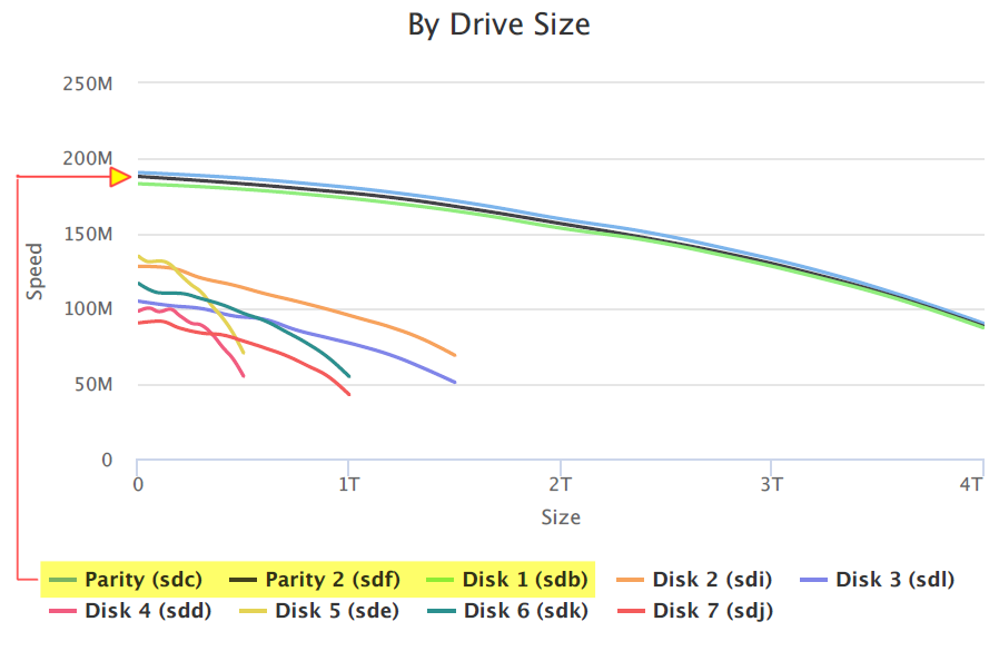

Nice Docker @jbartlett! Thank you.
Here are my results:
o Parity, Parity 2 and Disk 1 are brand new WD Red 4TB.
o Disk 2 and Disk 3 are WD Green 1.5TB
o Disk 4 and Disk 5 are salvaged 2.5 inch disks from old notebooks
o Disk 6 is a "shucked" disk from a portable HDD
o Disk 7 is also "shucked" disk from a WB MyBook
Edited by FlorinB

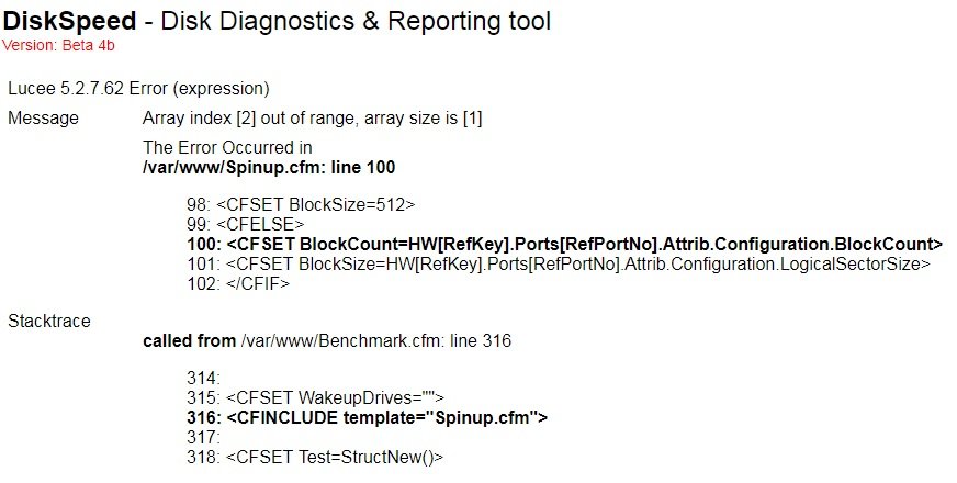

For a while now, I also get the array index out of range error, when trying to run a benchmark. It does not spin up any drives. Scanning works fine. Here is a screenshor of the error:
I tried to reboot the server and pulled a fresh image with a new appdata folder. No changes. Do you have any idea what might cause this?
Thank you!
Noted about the red outline style. It's more of a proof of concept thing and it would resolve the layer overlap issue. I've also found and fixed (in beta 5) the index out of range issue mentioned above.

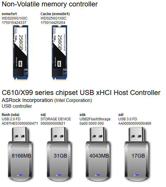

NVMe & USB drives will show up after the other storage controllers. USB drives will have a static image.
