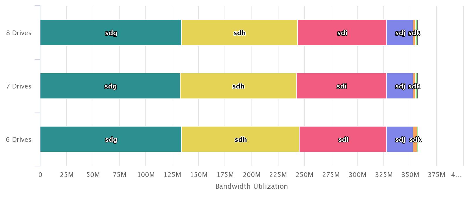

Hi.

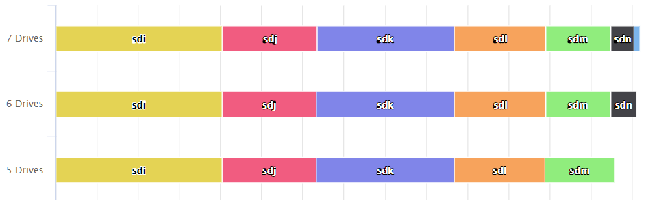

I run diskspeed for a controller that has 8 disks attached (attached file). The controller is an AOC-SASLp-MV8 (PCIe x4).
Do those results indicate that the 4x PCIe lanes are saturated by the 4 first drives? Or could it be something else?
That's fascinating.  It does look like that but I haven't seen any controller not load-share the reads like that. It should have kept scanning fewer drives though until it gets under 90% of the max throughput detected or it runs out of drives.

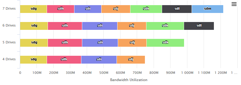

Here's a controller test on my test rig. It gives all the drives equal time on the first pass which maxed out the bandwidth even though it meant capping the read speeds of each drive.

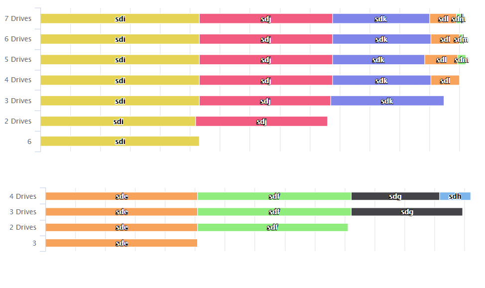

Wow, I like your graph much more than mine. So, my array has 2 AOC-SASLP controllers with 8 and 3 HDDs respectivelly. I moved one drive so that there are 7 and 4 HDDs on each controller, in order to exceed both controllers' max bandwidth. The balancing problem appears in both controllers. Maybe it is a problem with the controller settings. Maybe I should try disabling int 13h (although I never understood what that is)....
Edited by papnikol

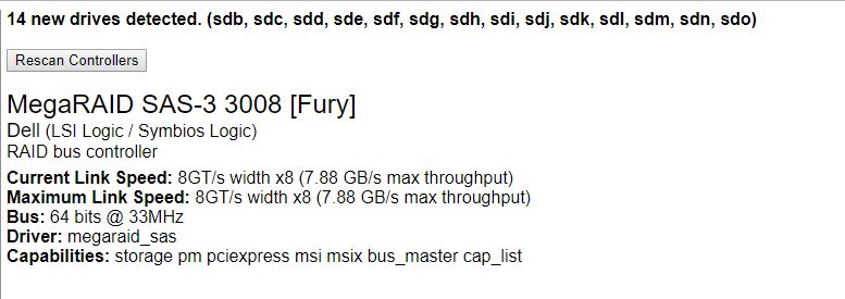

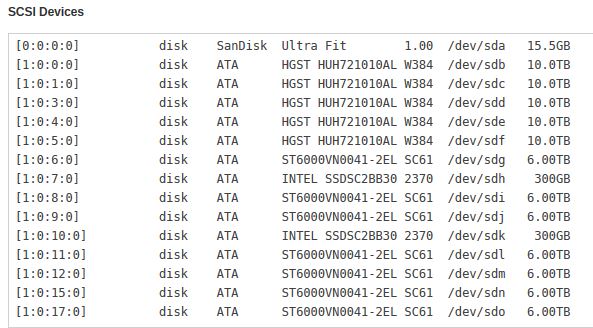

I think my SAS Expander does not play nice with drive detection....
Already send an email with the debug-file :)
5ae73ded4f4a9_diskspeedH330.JPG.c591825d2e6d1cd24fea66766a5cf3df.JPG5ae73df0dc08e_scsidevices.JPG.7e49feeabdb44438953ad6e16be18fcf.JPG

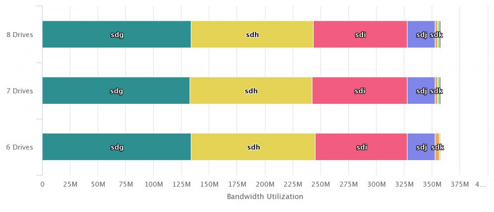

Hi.
How many CPU threads do you have available to unRAID (& Docker)? As in, not pinned to any VM or the like?
1. I have no VMs.
2. I have already changed my MOBO/CPU/RAM to much better configuration (but the 2 SASLP controllers remain).
MSI RD480/AMD Athlon 64 3700+/3GB
Asrock FM2A88X Pro+/: AMD Athlon™ X4 840 Quad Core @ 3100/8GB
3. These are the results for one of the controllers with the new configuration:
There is more bandwidth due to the move from PCI e 1.0 to PCIe 2.x. But still, the bandwidth is not balanced across all disks. The bandwidth usage is maximized for each drive until the last 2-3 drives have very little bandwidth available.
