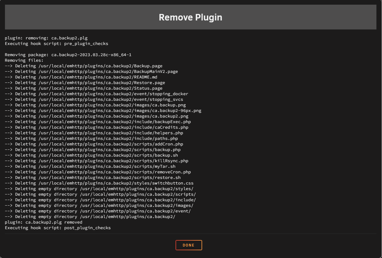

  2. Thanks Squid. For some reason, I swore that there was an actual "Done" text at the bottom of the script window when the script completed before.
  3. Just updated my unraid system from 6.11.5 to 6.12.8. Now every time I perform some management action with my plugins (install a new one, upgrade an existing, remove/delete one), the script window does it's thing, and then at the end, gets stuck on the line "Executing hook script: post_plugin_checks". If I click done, everything responds like the action completed successfully. I've attached the diagnostics from the system. unevan-diagnostics-20240302-1642.zip
