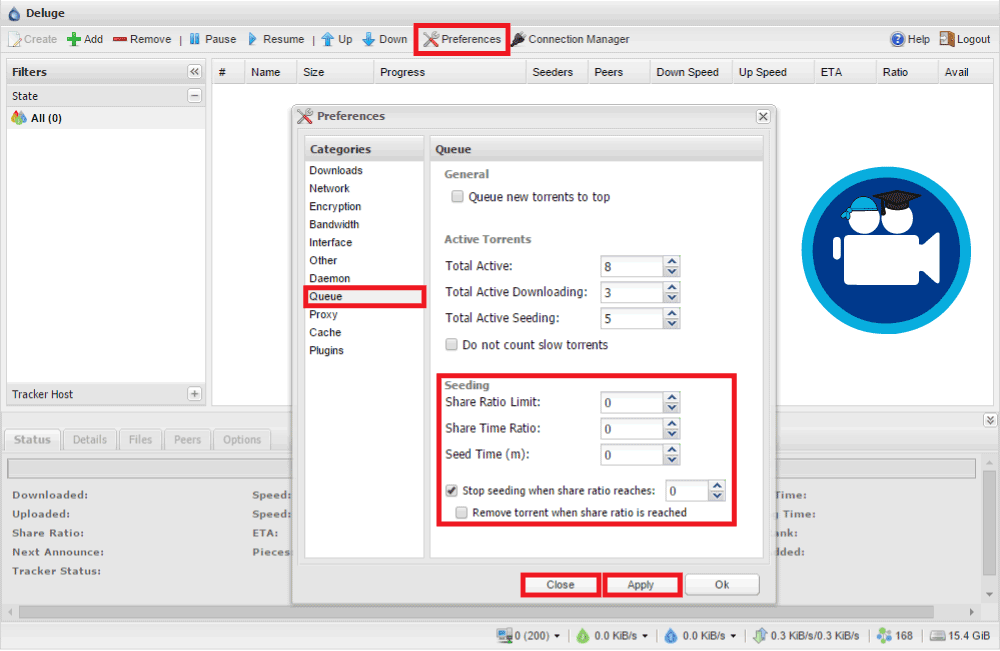

Hey All!
I have DelugeVPN and Sonarr setup and running great! Binhex you're a saint and a scholar!!  8) I have bought you a few beers!
I was just wondering if there is anyway ( I don't know if Sonarr does this or not) that after the download completes, to delete it from my Completed downloads folder? I see the files in my Media/TV folder but it also stays in the other folder. I know that seeding is super important, but it would be amazing if there were a way to delete after like a 3.0 ratio.
Thanks for your great work!
T
Hey All!
T
Firstly, thanks for the donation, you guys are keeping me motivated with the extra beer, and what good timing, its Friday yay! ;). I'm afraid i dont actually actively use Sonarr, im still ploughing on with sickRage for now, but i would of thought Sonarr could do this for you, perhaps a more seasoned user on here can chime in?.
Hey All!
T
Set deluge to stop seeding torrent after a 3.0 ratio and go to Sonarr and click on advanced view, then you can set Sonarr to delete files after it is downloaded.
Sonarr will delete it as soon deluge stopp seeding the torrent then.
(not my pictures, I am on iPad so just found some random online)
Sounds about right! thanks a buch!
