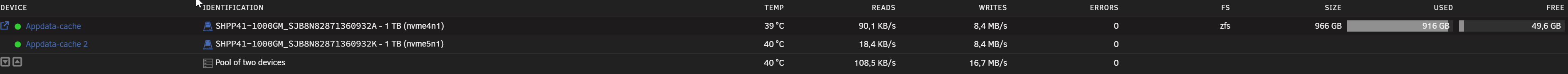

  6. I just figured this out. Kasm was the main culprit. I usually have my zfs datasets hidden. When i opened it up it showed that kasm had over 350Gb of data even though it wasnt being calculated during general operations. I'm guessing hidden files werent being shown. Anyway I dont use it often enough and got rid.
  7. So my appdata cache is currently sitting at 923GB used of 966GB. This pool only has appdata storage (excluding plex which has its own pool) when I calculate the size of the data stored within the appdata folder it shows that there is only 396GB storage in it. This is the only folder on the drive... That I can see. Is there any other reason this pool might be filling up? I've tried restarting docker. server-diagnostics-20251204-2009.zip
