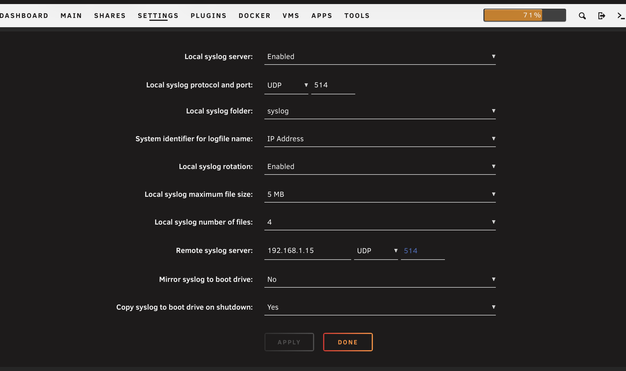

  4. Well, I looked just now after a restart, and it seems that I did have syslog server set up. I'll take a look and see if I can figure anything out and report back if I'm too dumb to understand.
