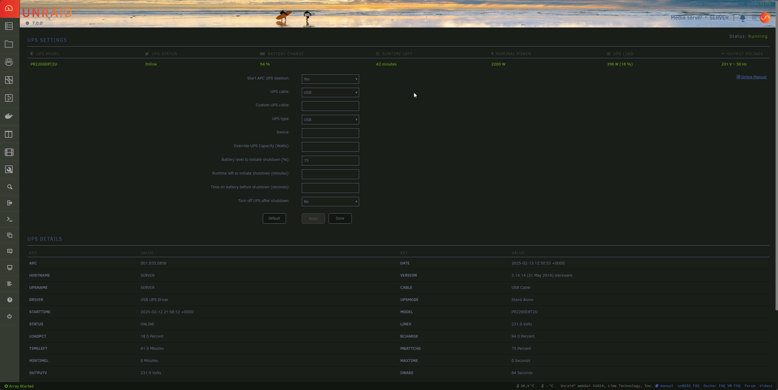

So I think I am having an issue where by if my power goes out and my UPS settings activates a shut down at 75% battery, once the server comes back online it will always say that an unclean shut down has occurred. It will then obv try to run a parity check.
I'm curious if this is standard or do I have an issue. I cant find the answer when googling. There is no issue with the UPS in that the server will fully power down while other electronics connected are still running so I know its not the UPS running out of battery before the server powers down.
It wouldnt surprise me if this was standard operation but I just wanted to check.
UPS - Cyberpower PR2200ERT2U

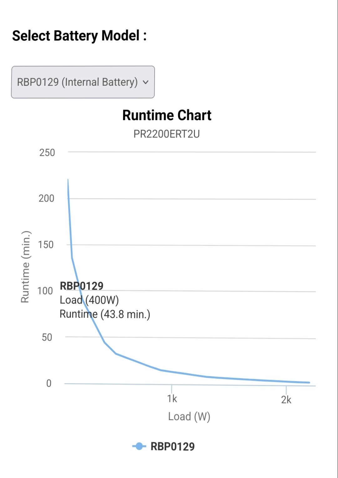

I know its not a battery issue or a time to shut down issue. I can unplug the UPS and I can see it gives an estimated time remaining of 45mins at ~90% load. Thats with a load of roughly 400W. My server maxes out at about 550W when all drives spin up.
I wouldnt have even known about this only we had a bad storm here 2 weeks ago and have had a few power cuts since while they are fixing power lines. I've included my settings on the off chance something there is stopping the command being sent correctly.
With compare the runtime chart, it indicate the battery in excellent condition, no degrade.

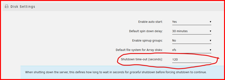

Under SETTINGS  >>>  Disk Settings is this setting:
(This is not the default time.  I have set so that this server can stop the array in less time then this setting.)    When the setting times-out, A forced shutdown will start automatically and the forced shutdown will always result in an unclean shutdown!  (Time the array 'stopping' time and add about 25% to that number for the setting.)

Weird.... shouldn't this be applied to all shut down requests? Mine is set to 90 seconds. but when a manual shut down is requested it never results in an unclean shut down. It only occurs when a UPS shutdown is requested.
I will try to extend it and see what happens. It shouldn't make any difference to my day to day use anyway. Thanks for the suggestion. It does make a lot of sense other than that I never get an unclean shut down when I manually do it.

Thanks dude I did see that. But as I have said a manual shut down never results in an unclean shut down and I assumed these settings apply then too. So I never even considered that my settings were an issue. I have re adjusted the disk timeout to be 180. But again there is no way to properly test this without pulling the power on the UPS. Which I'd rather avoid given that others have said it can cause degradation of the batteries.
Also the fact that other devices are still running post shut down of the server would indicate that there is sufficient time on the batteries to allow for the shut down. Which is why I was confused about my issue specifically.
Ok so between the disk shutdown timeout and immediate shut down request upon power loss this has solved my problem.
I'm going to assume the more likely culprit was the shutdown timeout given the other factors I explained earlier.
