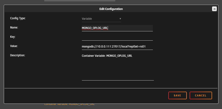

then modify the rocket.chat docker container adding the variable:
MONGO_OPLOG_URL: mongodb://<SERVER>:27017/local?replSet=rs01
restart rocket.chat and it should be working fine.

can you show me what you did in the config file?

I really wanted this to work, but when I add "-f /data/db/mongod.conf" to the post arguments it says it's successful, but the MongoDB docker won't start. I tried with and without the quotes.
Here's my mongod.conf

22 hours ago, Ladrek said:
@Frank76
Can you post your config file for us?
Sure... I see the problem. The echo line they said to in the link that I sent is supposed to be done from the command line, which ends up in the config file like:
replication:
  replSetName: "rs01"
here's my full mongod.conf:

replication:
  replSetName: "rs01"

replication:
  replSetName: "rs01"
I did the variable however rocket wont start now.
