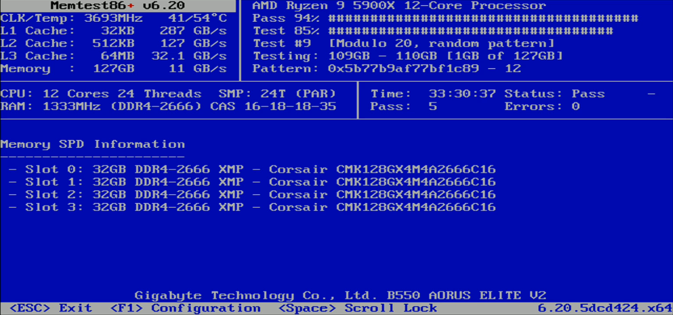

  11. I've started the memtest now, I'll let it run for 24 hours and post the result. I'll try the other device afterwards, I think I've got an old NUC somewhere I can add it to, or just use a VM on my desktop and pass it through. I'll figure it out. I see I was a bit off on that. It's still powered on, but it's unresponsive in anyway. No SSH, no WebUI, even the local terminal is unresponsive. Network wise it also disconnects. I've tried 3 different USB ports, 2 of the USB2 and one of them USB3. I'll try another set as well, just to be sure. That'll be after the memtest since I've alreadt startarted it. I'll let you know tomorrow. Thanks so far guys!
