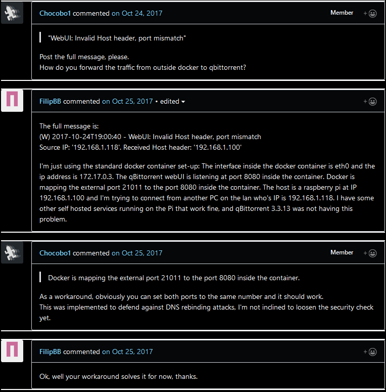

Note 2: qBittorrent will throw a WebUI: Invalid Host header, port mismatch error if you use port forwarding with bridge networking due to security features to prevent DNS rebinding attacks. If you need to run qBittorrent on different ports, instead edit the WEBUI_PORT_ENV and/or INCOMING_PORT_ENV variables AND the exposed ports to change the native ports qBittorrent uses.

On 4/24/2018 at 8:08 AM, whauk said:
Take mine - I have the same problem..;-}qbittorrent.log
Hi Whauk,
Thank you for providing that log. qBittorrent implements a security feature against DNS rebinding which seems to be messing with Bridge/HOST configurations and port forwarding done by Docker. Im about to update the container to allow people to change the official qBittorrent ports with environmental variables.
Source: https://github.com/qbittorrent/qBittorrent/issues/7641
Edited by MarkusMcNugen

My issue now is that changing the two given webui ports to the port I want seems to keep the 8080 port involvement, and then not let me access the webui anymore.
If I just use 8080 it works fine. is there something else I need to edit here that I cant see?

Edit: I was reading up on the other qBittorrent dockers and they seem to have the same issue. It might be a limitation of some kind. Let me know if you work around it. I'd love to change the port.
