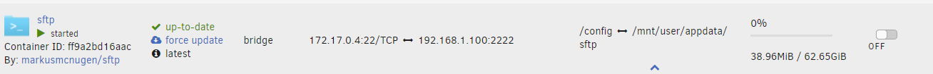

Sorry for asking probably stupid questions but I could need a little help with the sftp app.
I have the container running and added one user in the /mnt/user/disk1/appdata/sftp/sshd/users.conf like mentioned on the docker page:
user:pass:1001:100
When I connect with filezilla I land in this folder:
Unfortunately I can not copy something in that folder: I have read permissions, I can copy that .ssh folder for example.
And generally read persmissions are enough but how can I specify the folder for a user when I connect to the server.
I thought about passing a folder from the host to the containerlike this:
But I dont know where I can configure that. Can anyone help me ?

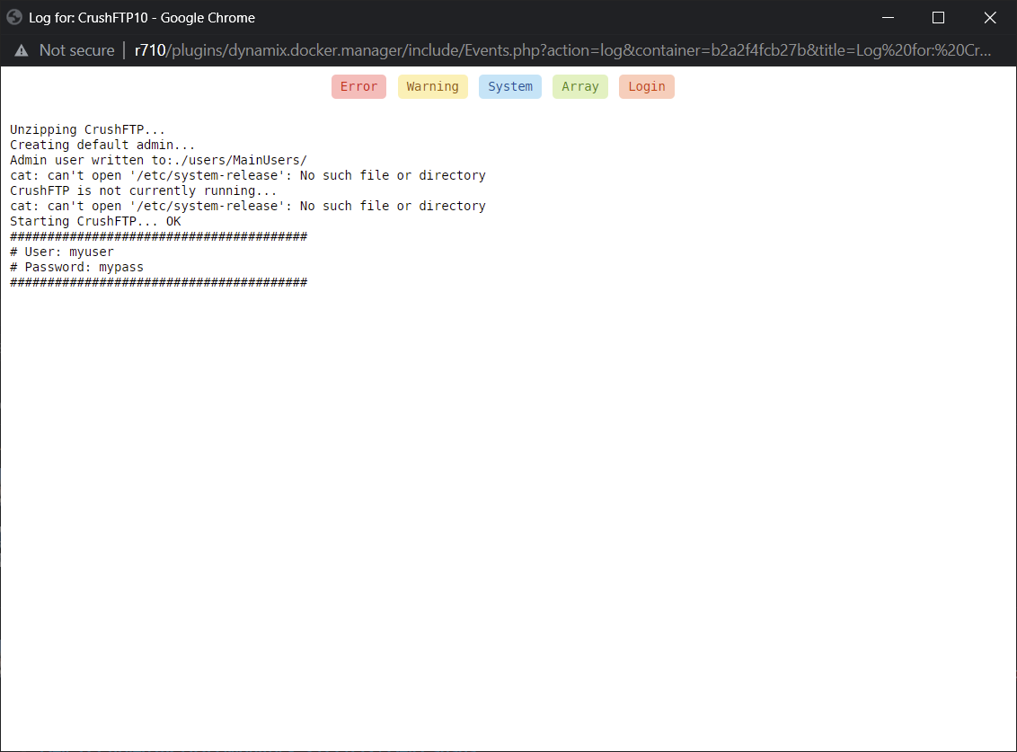

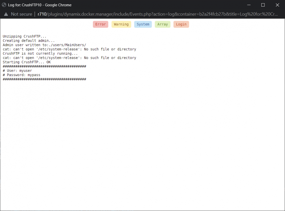

I probably did something to muck this up. Once installed and the container starts I cant access the ui. When looking at the log this is what I get.  Is there a permission I am missing?
Unzipping CrushFTP...
Creating default admin...
Admin user written to:./users/MainUsers/
cat: can't open '/etc/system-release': No such file or directory
CrushFTP is not currently running...
Starting CrushFTP... OK
Hello,
I have the same problem

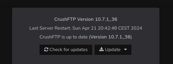

Anyone running the CrushFTP10 container should be aware that there are several critical vulnerabilities in the version of CrushFTP being used (10.0.0). Details are available on their wiki: https://www.crushftp.com/crush10wiki/Wiki.jsp?page=Update
I'm not sure what happened to MarkusMcNugen, but he seems to no longer be maintaining these projects.

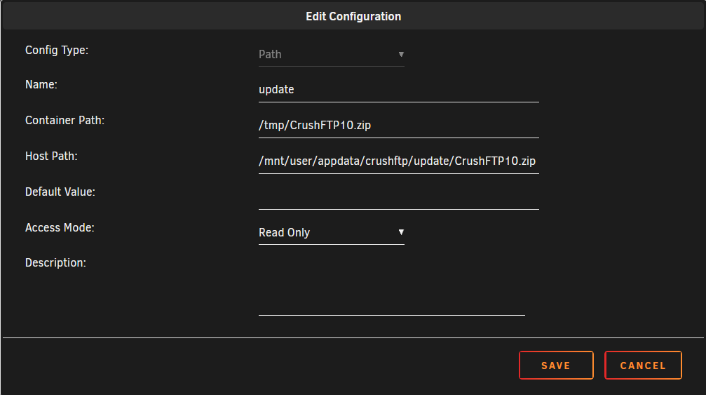

Here's a workaround to this problem:
1. Download CrushFTP 10.7.1 from CrushFTP's website: https://www.crushftp.com/early10/CrushFTP10.zip
2. Save the file into your CrushFTP appdata folder. eg. /mnt/user/appdata/crushftp/update/CrushFTP10.zip
3. Add a new path, mapping the update file to /tmp/CrushFTP10.zip (case-sensitive). The container looks for this file on startup and auto-applies the update, if present.
4. Be sure to set the mapping "Read Only", otherwise the file will be deleted after the update and you'll be back to 10.0.0 on the next startup.
Edited by Transient
added workaround
