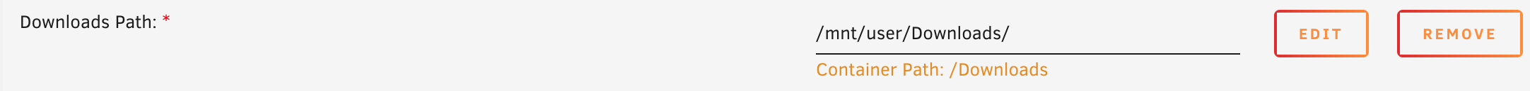

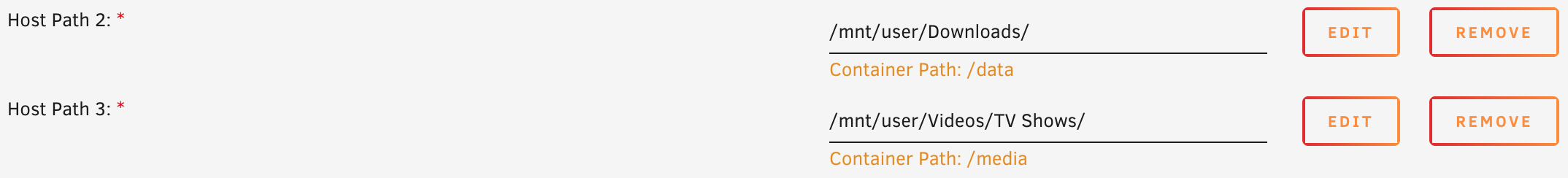

I seem to be having a issue with Sonarr and qBittorrentvpn v4.1.9.1. It was working great before, but now it won't finish moving/renaming after it completes the download. I just get the warning "No files found are eligible for import in" and I check there and the file is there. Anything I should do to get it working again? I'm at a loss right now what to do.
Odds on its mis-matched path mappings between sonarr / qBittorent
https://forums.unraid.net/topic/57181-docker-faq/?tab=comments#comment-566086
Nothing changed there. That should do it right (or am I missing something obvious)?
qBittorrent VPN:
Sonarr:
5 minutes ago, yanksno1 said:
obvious
Container Path : /Downloads
Container Path : /data
They are not the same.  Change one or the other
Thank you! That was it. Forgot to update when I re-downloaded Sonarr. Thanks a bunch.
