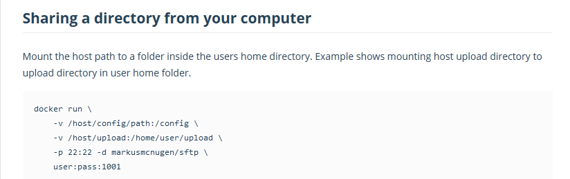

Trying to get the SFTP docker working but I'm having some trouble. I've read the github page but it isn't exactly clear.
So far I have created the users.conf file and added a single user as mentioned on the github page. The container now starts, but I am unsure whether or not I am supposed to run it in 'host' or 'bridge' or something else. It's just running on port 22. As follows:
I haven't set a directory yet to share, but I want to share the main storage directory. In this case it's "/tank"
The problem is, that I cannot even log in yet with Filezilla on my Windows PC. The connection just keeps timing out. I don't understand why.
Can I get some help?
Edited by plantsandbinary
Hi MarkusMcNugens,
I've installed the sftp docker, configured users with users.conf, and added user keys. I can see that the docker created the users appropriately and copied the user keys to their respective authorized_keys files as well as copied the userkey files to their respective folders correctly. The problem I'm having is that when I connect to the SFTP server, I'm able to log in without using my userkey in my client (only the password is required). I've restarted the docker, but the issue persists.

I was reading through the documentation regarding the sFTP docker and it appears i have to specify the home path for each user directly in the startup string of the docker container. Does this mean i can only have 1 user with 1 home path per SFTP container and not multiple different users with multiple different home paths?

Hello.
I installed sftp on unraid.  Got the container to start after going through unraid console and manually adding a user.  However; when I sftp (using putty) I authenticate and then putty just closes.
Nothing in the sftp container logs that i can see, just that I had successfully authenticated.
Apr 6 00:45:12 b34201513c63 sshd[52]: Server listening on 0.0.0.0 port 22.
Apr 6 00:45:12 b34201513c63 sshd[52]: Server listening on :: port 22.
Apr 6 00:46:23 b34201513c63 sshd[73]: Accepted password for <username> from 10.180.5.50 port 59361 ssh2
the first two lines above; do I need to configure this container further?
