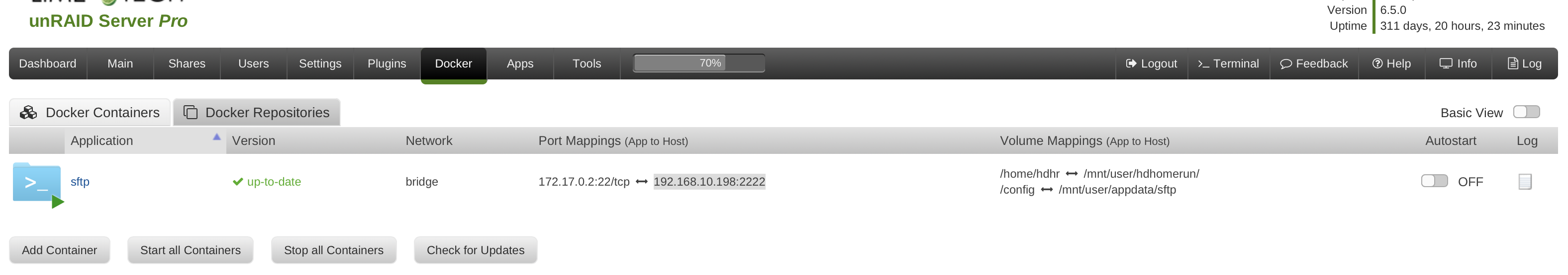

  10. I'm having the same problem. I think I've created the home directory. This is my users.conf: #user:pass:1001:100 hdhr:hdhr:1002:100 Here is my output: MacBook-Pro:~ dga$ sftp [email protected]:2222 [email protected]: Permission denied (publickey,keyboard-interactive). Connection closed MacBook-Pro:~ dga$ The unRAID ssh server is configured to only use a key and no passwords. Could those settings be affecting the docker? What additional configuration is needed? Thanks, David docker log: Mon Jan 28 23:25:04 America 2019 [info] Existing jail.conf found. Copying to container filesystem! Mon Jan 28 23:25:04 America 2019 [info] Existing sshd_config found. Copying to container filesystem! Creating users... [entrypoint] Parsing user data: "hdhr:hdhr:1002:100" * Starting system logging syslog-ng ...done. [entrypoint] Executing sshd * Starting OpenBSD Secure Shell server sshd ...done. [entrypoint] Executing fail2ban * Starting authentication failure monitor fail2ban ...done. Jan 28 23:25:05 c682e4b023fa sshd[71]: Server listening on 0.0.0.0 port 22. Jan 28 23:25:05 c682e4b023fa sshd[71]: Server listening on :: port 22. Mon Jan 28 23:29:44 America 2019 [info] Existing jail.conf found. Copying to container filesystem! Mon Jan 28 23:29:44 America 2019 [info] Existing sshd_config found. Copying to container filesystem! * Starting system logging syslog-ng ...done. [entrypoint] Executing sshd * Starting OpenBSD Secure Shell server sshd ...done. [entrypoint] Executing fail2ban * Starting authentication failure monitor fail2ban ...done. Jan 28 23:29:44 c682e4b023fa sshd[51]: Server listening on 0.0.0.0 port 22. Jan 28 23:29:44 c682e4b023fa sshd[51]: Server listening on :: port 22.
