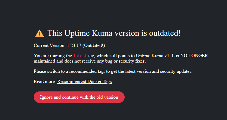

  1. I just installed the docker via unRAID app store and I'm getting this notification that it's outdated. According to unRAID, the docker was updated yesterday

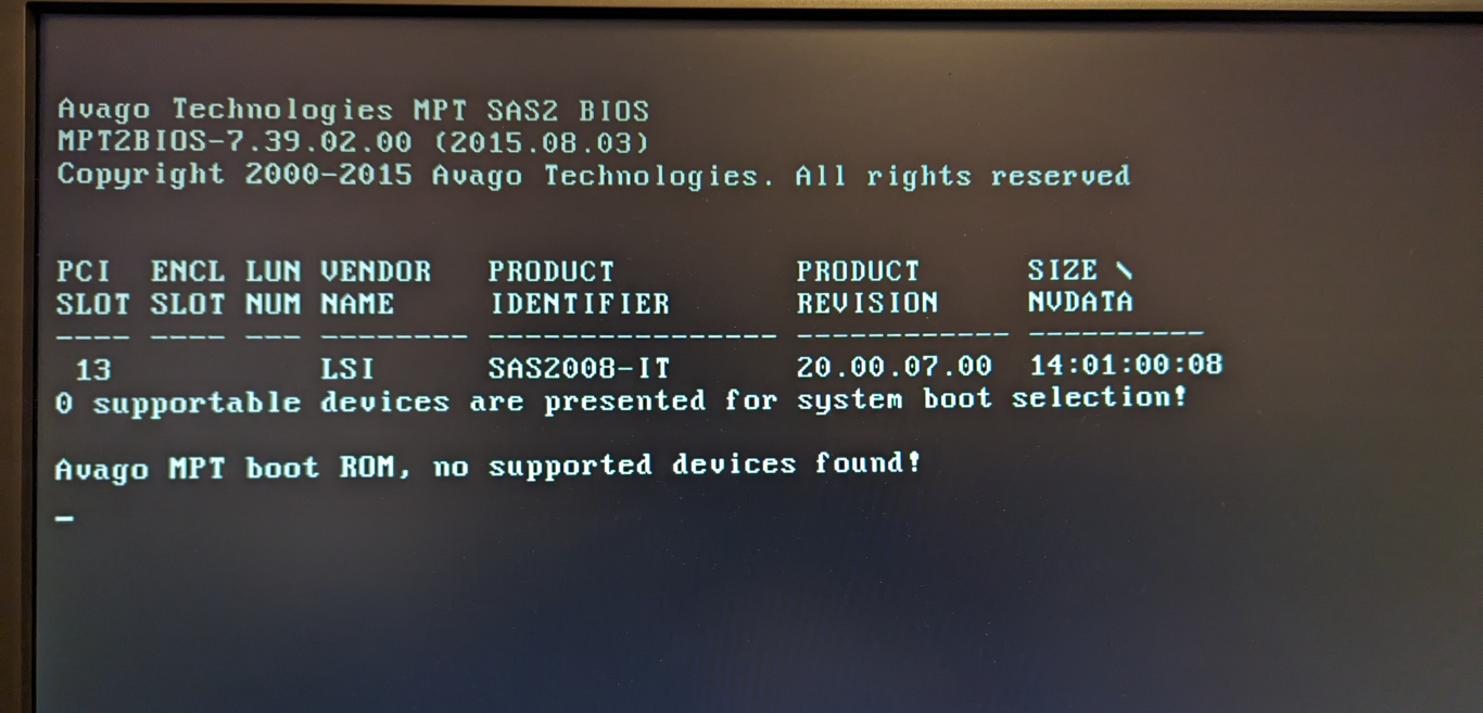

  13. Ok I'm going to keep an eye out for future errors. Is there a simple way to get unRAID to give notifications when a mce occurs?
  14. My system is overdue for an update. And in preparation I was running fix common problems and saw this. This is the first I've ever seen this in the few years I've run this config. What's the most likely cause for this? Could it be a CPU stability problem? CPU 1 is pinned to a Windows VM that stays running 24/7. nas-ng-diagnostics-20241213-1234.zip
  15. Keep in mind, the plug-in is just a front end for executing sleep commands on a schedule. If you initiate sleep via the terminal, I strongly suspect you'll have the same issues waking up. My old system had major problems with its HBA card after waking from S3 sleep. The issue was fixed after updating my motherboard to the newest BIOS. So I suggest seeing if updating all your firmware fixes the issue.
