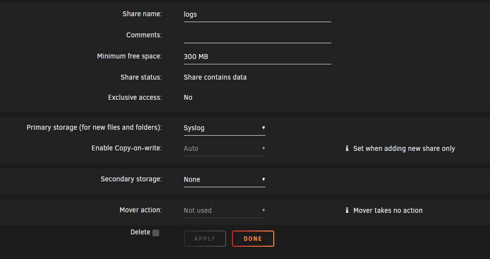

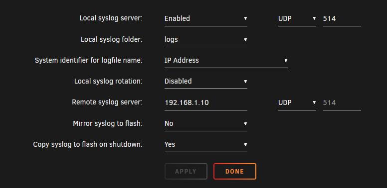

Note: this can also be done by assigning the syslog to a pool device.  In the case of the card reader explained below the micro SD slot can be set up as a pool device.  On one server, I have a share called "logs" assigned to the Syslog pool device.

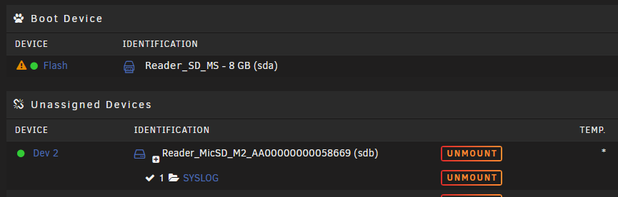

  2. Put the card in the reader and mount it as an Unassigned Device in unRAID.  As seen below, the boot flash is in the SD slot and I now have the SYSLOG card in the Micro SD slot. Yes, the flash drive is public (not recommended) while I did this.image.png

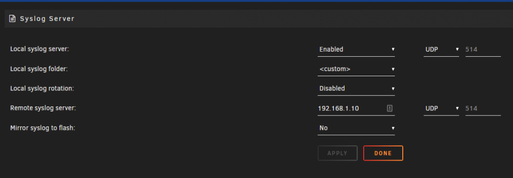

  6. Disable and then Enable the syslog server to restart it and force it to read the new config.  The local syslog folder should now show <custom>image.png
