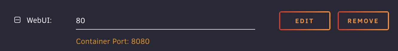

  8. Indeed it works with bridge. Thanks. Is this template unique? I mean usually I can change the port with a dedicated ip. How to know when the web env variable is only for bridge ?
  9. Hello, I just installed Privatebin I've setup a WebUI port but it still listen to the default 8080 only 🤷‍♂️ I tried with dedicated ip or host network config.

  13. Hello, About the docker Dozzle, Even when we change the env variable WebUI for another value, the daemon still listens to 8080. This env. variable is by default in the template.
