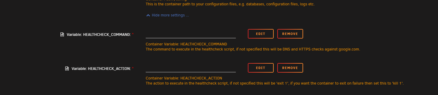

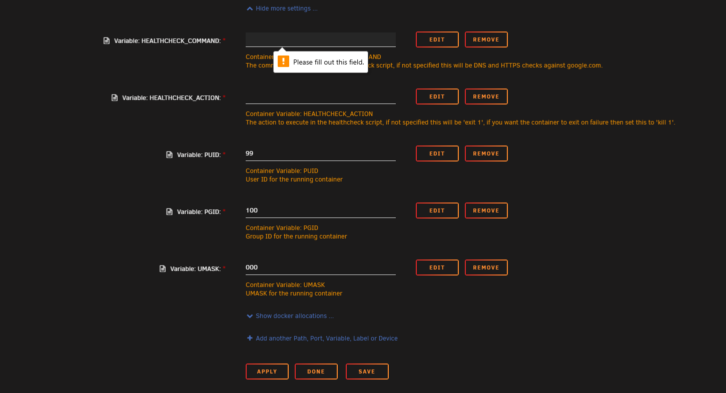

  1. It does not allow me to apply and start the container without something being there
  2. Im very sorry if this is obvious but im trying to setup this container and i just simply dont understand the 2 blank variable spaces and what is suppose to go there.
  3. Did you ever get this figured out ? i am having this issue right now .
  4. did you get it back up and running ? im in the same boat right now

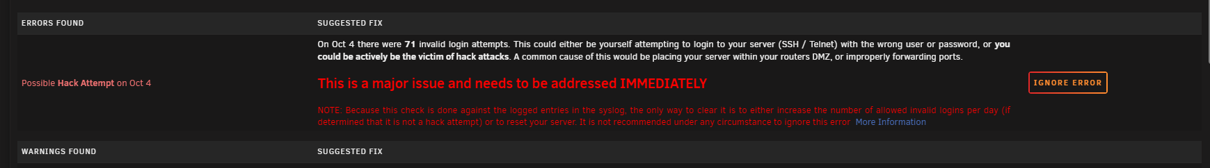

  10. Good afternoon, I recently just noticed this warning from FCP which is very unnerving for me. Can anyone shine some light on this ?. i am hoping its nothing more than a local device trying to connect. tower-diagnostics-20231014-1541.zip
  11. Was this while pulling down the docker for the first time or after you had set everything up ?

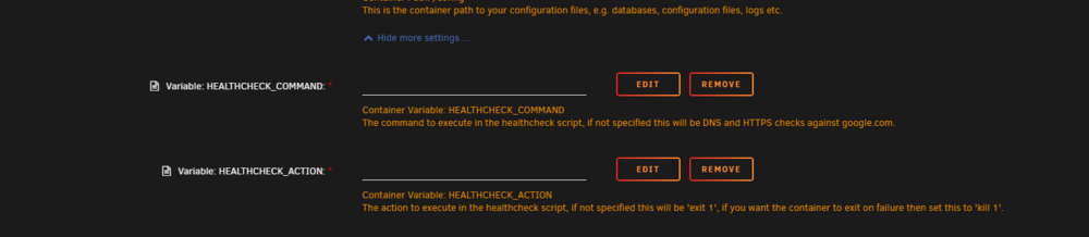

  13. Would you be able to tell me what path i am suppose to put in the screenshot specifically ?

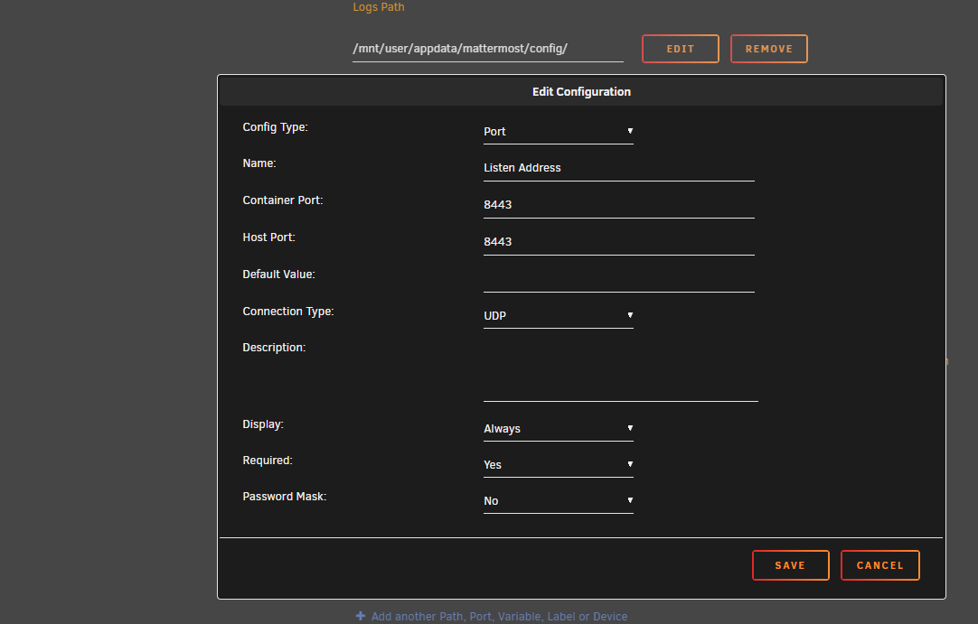

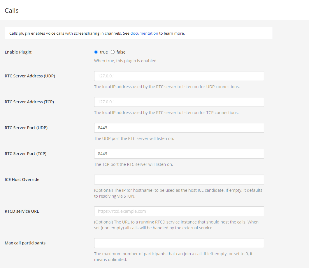

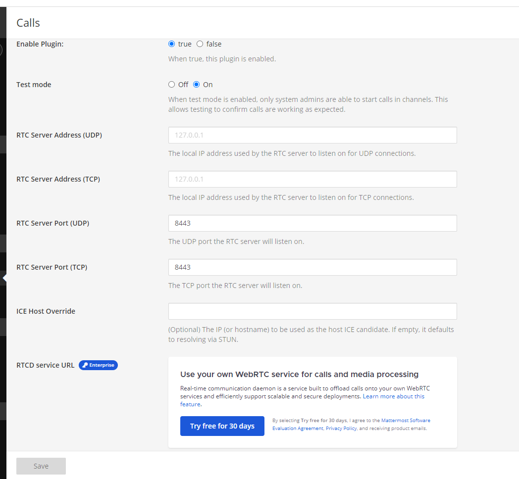

  15. Has anyone ever gotten calls within mattermost to work ? i keep getting an error even though i have ports 8443 and 8065 forwarded, i also have it properly reverse proxied with swag. I am hoping its something simple, please tell me what im doing wrong
