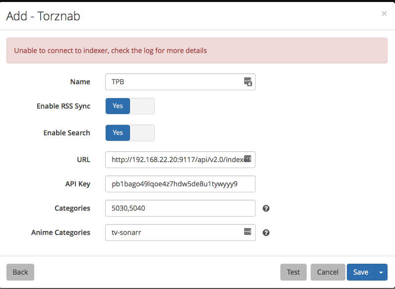

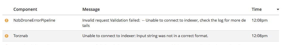

Is anyone else not able to get Jackett to work lately?
Sonarr, Radarr are install correctly.
Jackett installs just fine, when adding a search engine like TPB or EZTV, everything tests fine.
When adding the TorzNAB (custom) and inputting the info, I keep getting generic error in Sonarr's log. Google and other searching isn't really yielding any direction...
I couldn't get this to work either. I also had issues adding some of the indexers in general.
However, I think the anime category would have to be a numeric value also, like the categories above.
Edited by jebusfreek666
i will see if i get time to have a look into it, im using it myself.
Try TorrentPotato preset instead of customNZB if you are actually searching against a torrent site.
My Radarr is setup this way, still used the jackett nzb link though
FYI you should obscure your API key when posting on forums etc
Edited by tjb_altf4

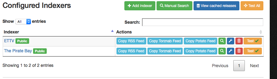

I am not really sure what the deal is, but I am pretty sure it has to do with the sonarr/radarr side of things. I can test the connection to TPB in jackett, and it works fine. But copying and pasting the URL provided does not work.
Also, is there an updated version of jackett available? I see the above post has ETTV. The only public ones on the docker that I have is Rarbg and TPB. I would also like to see EZTV, and thought these were already included?
@mkyb14 works for me fine, remove whats in anime categories thats probably your problem, where did you get that from?, it looks like tpb doesn't have a anime specific category.
@jebusfreek666 - its the latest release, the only reason there were only two showing is cos mkyb14 only had enabled 2 index sites, there are a LOT more to choose from (via the add indexer button).
tip of the day: you can actually consolidate all enabled index feeds from jackett by changing the url from <named index site> to "all", this means you dont need to add each index site manually to sonarr, radarr etc.
I know that he only had 2 added in the picture. What I was saying was that it seems like there is only 2 public sites listed on the jackett docker, or only 2 that do not require username and password info. I could be wrong, but I think all the others listed are either semi-private or private. But I am not 100% sure about that.
As for adding multiple index feeds from jackett with one link in sonarr/radar, and changing the url, what format would that look like then? I am assuming https://serverIp:port/all? is that it?
im not sure where you are looking but i see literally dozens of "public" index sites listed in the ui, none of which require username or password *shrug*.

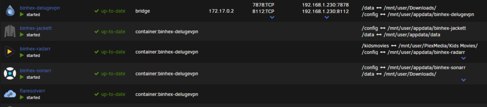

I'm having trouble connecting to Jackett from Radarr/Sonarr when using delguevpn privoxy.
I have Jackett and Radarr proxy settings set-up as below.
Jackett
Radarr
Radarr is able to connect fine to deluge, and Jackett is able to connect fine to the indexers.
However, Radarr is unable to connect to Jackett. When I turn off the proxy settings of Radarr, I am able to connect.
Any ideas? I'm new to this so let me know if I'm missing something obvious.

Hi guys,
Radarr would only work when the URL had the exact ip address of my unraid box, but it wouldn't if I set the URL as "localhost:9117(...)" or "127.0.0.1:9117(...)". Not sure why that is happening.
On 2/7/2018 at 8:55 AM, binhex said:
so for example you would configure sonarr/radarr etc with the following:-
http://<host ip>:<port number>/api/v2.0/indexers/all/results/torznab/
Right now my URL is set to "http://10.0.7.15:9117/torznab/all/". Is there a difference between that and the URL you mentioned, i.e. "http://10.0.7.15:9117/api/v2.0/indexers/all/results/torznab/"?
because if you set the url to localhost then radarr will try to connect to jackett using the localhost address inside the radarr container, obviously the radarr container is only running radarr (and not jackett) and thus it fails.
not sure what the difference is with the url's but mine works :-).
Thanks for the reply!
Yea but they both have their network set to bridge. Both have the same IP address. Wouldn't at leats the loopback work? Or am I missing something?
Think of each container as a tiny VM. loopback only works inside each individual container. Container to container communication goes through the docker network.
