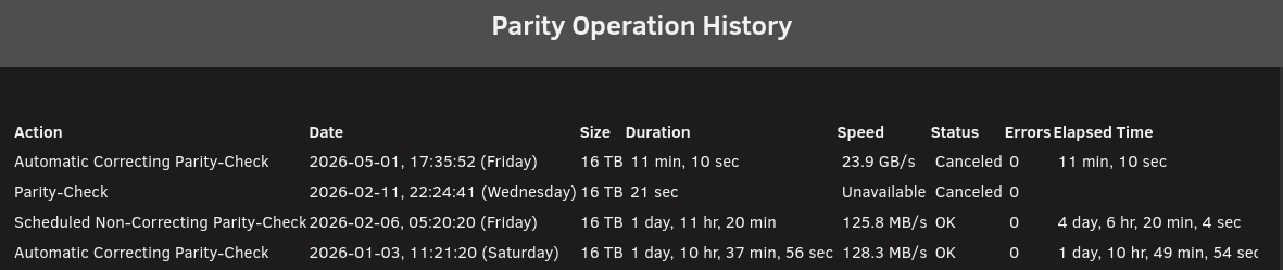

  6. It seems every time I boot my server, I get notified of an unclean shutdown and parity runs. I just ignored the issue before, but it's bothering me as why my server doesn't seem to think the update from 7.2.4 to 7.2.5 is an unclean shutdown. Also, I don't know why my server would think that the 'Reboot' option from the Main page isn't a clean shutdown. I've attached the diagnostics from right after the reboot, although I believe they won't have much information in them. Therefore, I'm also attaching diagnostics from a few days ago when I was trying to diagnose another small issue (can' see notifications unless I press Alert, Info, All Types, Warnings, then back to Info). I noticed that issue in 7.2.4 (not sure if it started when I updated to 7.2.4), but I switched from black to white color scheme and it made no difference. Should I re-run a complete parity check again or is there something else that might be triggering an unclean shutdown notification? tower-diagnostics-20260501-1740.ziptower-diagnostics-20260427-1311.zip

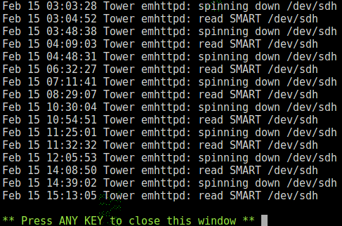

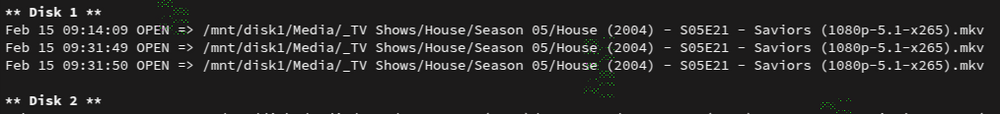

  10. I have no idea, chrisb42, but I have the same situation. I also thought I had a lot of reads on the array, but I couldn't find anything that causing the issue. If I looked at the disk log for each disk, there seemed to be files opened (by what, I have no idea!) but those files shouldn't have been opened in my opinion. There was no one watching those files on my Plex so no idea why they would open. I also have just posted that I thought I was getting a lot of reads on the disks, but maybe I'm mistaken. As an example, When I check the file activity under Tools | System Information | File Activity, I see the last activity was from this morning about 9:30, when I watched an episode of House: The disk log information for my disk1 (the icon immediately left of the identification column on the main screen) looks like this: I have no idea what might be causing the drive to spin up and read SMART information. However, disk1 (sdh) above suggests it might actually spin down for durations ranging from about 2 minutes to 2 hours. This is better than it was in the past, as I think the spin down was only 1 to 2 minutes each time before SMART was read again. Despite my efforts, I couldn't find anything accessing the disk, but I ended up uninstalling the disk cache plugin as I thought this might be keeping my disks spinning. After removing the plugin, I'm not sure if things are better, since every time I look at the Main window in Unraid, my disks all appear to be spinning. Contrarily, I have long pauses/delays when accessing files on the server, which suggests the drives might have to spin up before I access them, but I'm not sure since I never see them spun down. Maybe the indication on the Main page isn't accurate??? Anyway, I hope you get some resolution, as I'll be watching this thread in hopes to improve my setup. ATE
  11. Thanks, JorgeB. When I toggle that, the disks don't seem to have much consistent activity (actually, very little activity). So are you saying the disks aren't being read by something or if they are, that is normal? I'm curious if you/others toggle theirs as a comparison to mine.
