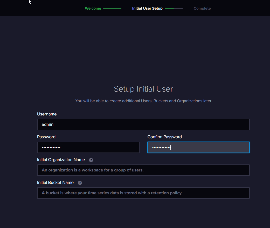

  9. Everytime i open influxdb it goes to the initial setup, Am I doing something wrong? edit: I go to the directory for the appdata... and the folder is empty?
