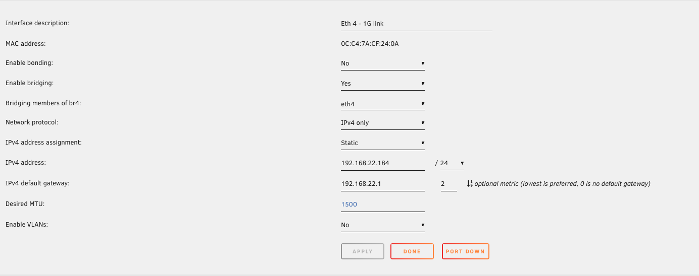

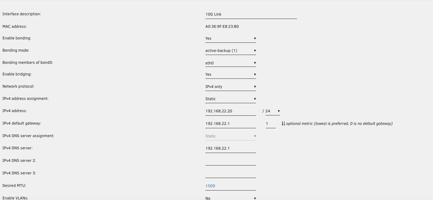

  5. yes, ecc ram has run memtest for 48hrs previously, no issues there or with board. current bios for supermicro along with latest on all hba cards. burn in in safemode is fine, now that this is running, I'll setup plex again with the variables and then setup sab,sonarr,radarr and see what happens over the following week or so.
