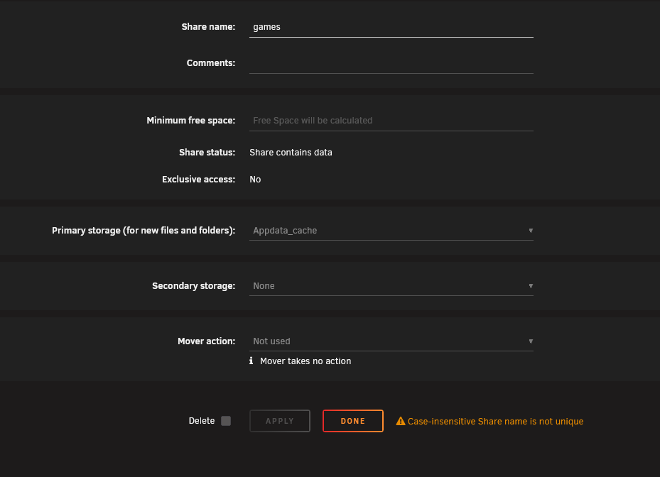

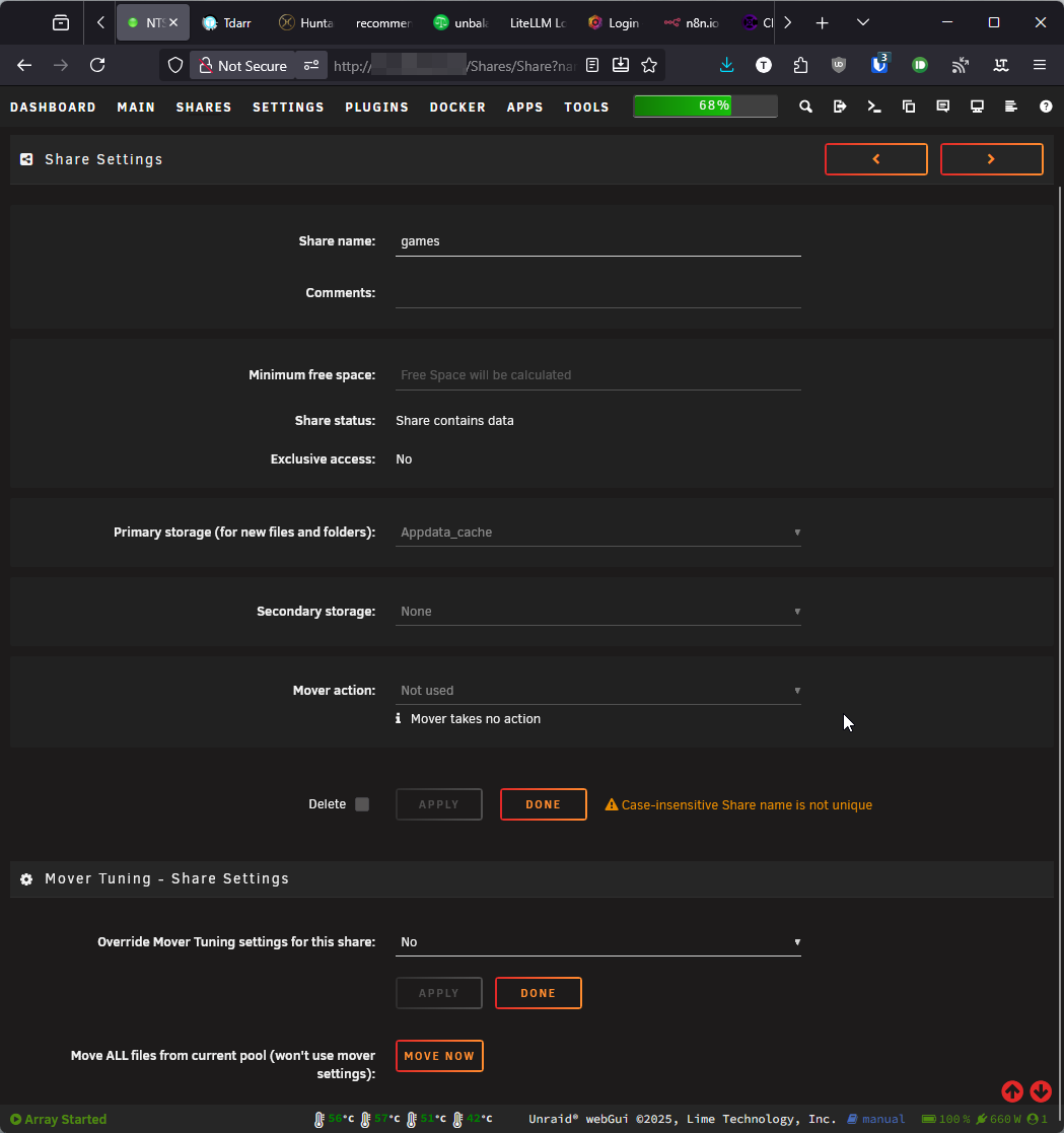

  2. Thank you, JorgeB! This was the solution! Good catch lol. I never knew that the shares were saved in the flash drive, especially that the name doesn't get updated when you do it in the unraid shares UI. Anyway, thank you again!

  4. Hello All, A bunch of my shares are not showing up in my explorer like usual. I went into the shares settings and I see that most of the settings are missing. I could still navigate it using that small arrow on the left and see all the files are there. Not exactly sure what is happening, this is the first time I see this issue. I also noticed that on the main "shares" page, the "Storage" column is labeled wrong. For example: my "games" share is array only, but the main page shows "Appdata_cache" This share is also not showing up in my Windows 11 machine. It is set to export: public (always been). So i'm not sure what the issue is. Should I just downgrade back to 7.1.4? Thank you ahead of time. ntserver-diagnostics-20250923_0329.zip

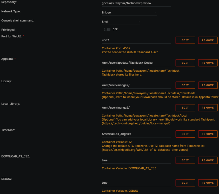

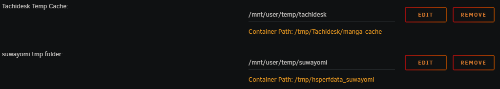

  10. Nevermind, I figured it out. Apparently it is using the dir /temp to download the images files and then putting it into the nzb in the "library" folder. This leaves all the images inside the temp folder without cleaning them up afterwards 😑 Anyway, I mapped those dir temp like this (remember to change the permission of the folders using Krusader or tachidesk won't be able to write downloads in there): I may end up just mapping the whole temp folder, since it seems to be creating other things in there. Another thing i notice is that each time i restart the container, the download list disappeared resulting in me having to re-add the downloads in the GUI. Not sure if this is related.
  11. Unfortunately, turning the debug log off did not help. Any clue on how to trace down what exactly is filling my docker img? "docker system df: only gives an overview and spaceinvader's scripts gives more detail but only that the container is taking up a large amount of space and not what the space actually is. I also went into the container's console to look at the structure and not able to see any folder with large sizes. I'm stump 🤔

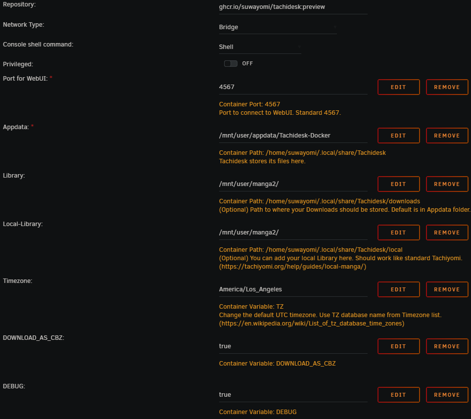

  13. Hmm I notice that this is leaking data into my Docker img. My docker went from 32-ish percent to 100% overnight. Here is my mapping: I don't think I miss anything looking at their documentation. I am using the "preview" channel.

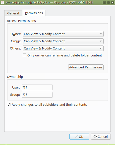

  14. I did! But for some strange reason, nothing loaded. I wiped the appdata and the container data and tried it again but same issues. The webui was not loading for some reason. I gave up after that lol 😆
