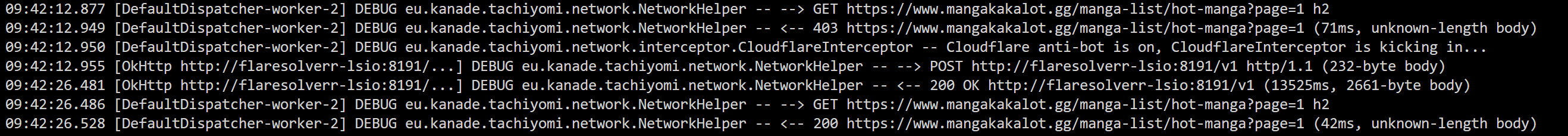

  1. Ok, Networks works. Tachidesk can access cloudflared too. I think the reason Tachidesk doesn't access Flaresolverr is because it gets the some other http status code. Flaresolverr only get's accessed when Tachidesk needs it to solve a captcha. It's good that it works on the windows pc (which client do you use there?), we can backtrack from there. So what are the differences between the both setups? Are the unraid host and Windows machine on the same network, and or the same internet connection? Is any of those using an vpn for internet access? Do your unraid server and windows machine use the same dns server and do they get the same answers?(Check with nslookup mangakakalot.gg on both machines; the container doesn't have the command, use the unraid console) If you still have the dns command on the container remove it. In the github keiyoushi issues tab the reasons i've seen so far for managakakalot to not work are only Ip-ratebans for too many requests. But that would affect the windows setup too(if they are on the same network). Otherwise you can try the different mangakakalot mirrors in the extension settings. Otherwise an old Tachiyomi post suggested deactivating dns over https, but suwayomi doesn't have that, so your upstream dns server decides that. Lastly enable debug logs in tachidesk and check what it says. Heres mine: One should first get the 403, then it should recheck over flaresolverr to get workable cookies and smoot sailing from there. Maybe one of the closed issues could help too: https://github.com/keiyoushi/extensions-source/issues?q=is%3Aissue%20state%3Aclosed%20mangakakalot Kind Regards

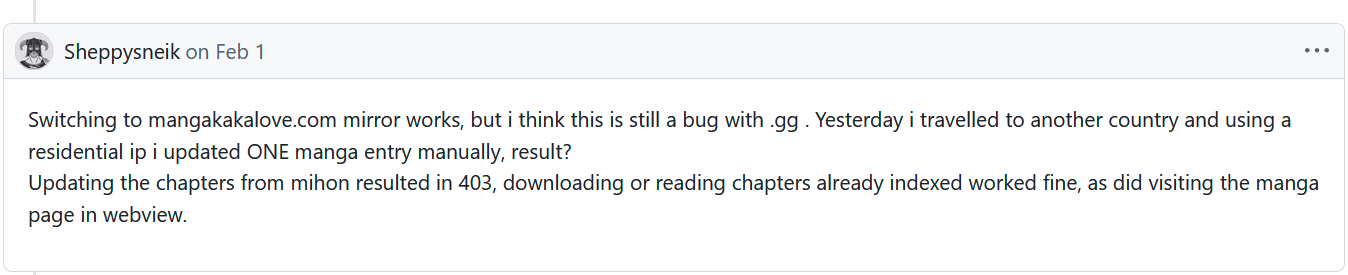

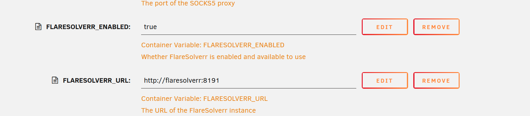

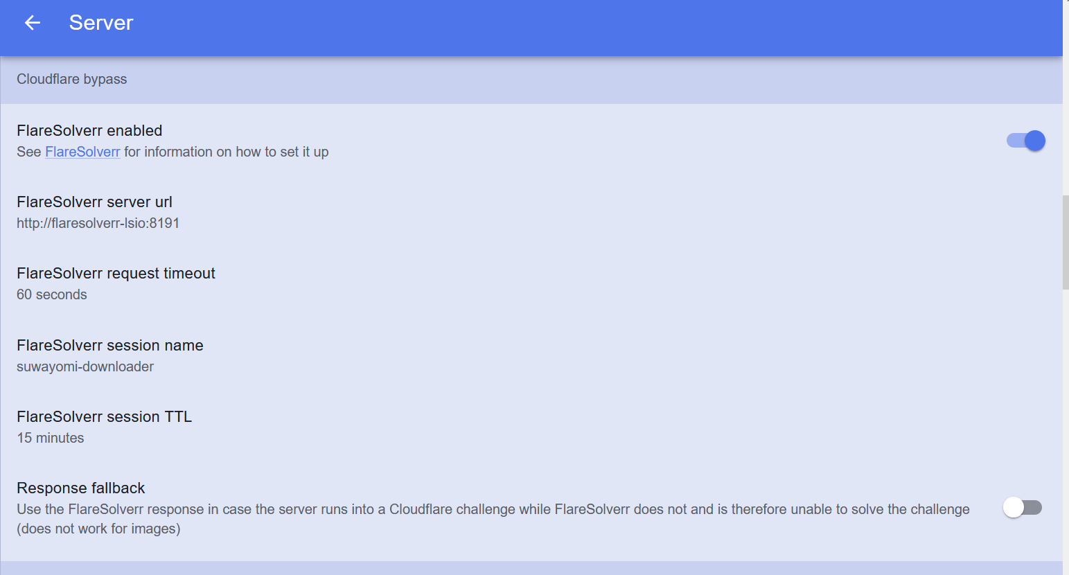

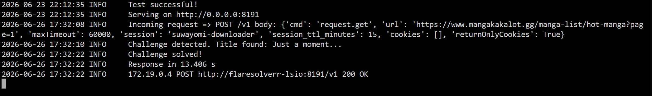

  2. Okay, we seem to have two problems. First we need to get flaresolver to talk to tachidesk, second magakakalot seems to be one of the most ip-ban friendly agregators out there. For the first one: open the console of tachidesk and type curl http://flaresolverr:8191 If we get a failed to connect message we need to recheck the network setup; send the docker run of both containers for that. if we get the flaresolverr message body we check the tachidesk settings. Go to tachidesk webui goto settings --> server --> scroll down, there should be a flaresolver section. Here my setup: Now for the second problem. Mangakakalot seems to have a low threshold for ip bans to keep bots away. See https://github.com/keiyoushi/extensions-source/issues/13106. Recheck in your webbrowser if you can reach the site. If you get a bad response your ip got banned. In that case offload some titles away from mangakakalot. First try changing kakalot mirror; see here (from previous link discussion): Further we should migrate some titels away. My extension recommendations would be in order of priority: specific website of scanlator Mangadex MangaK (former batato) other sites (if batoto doesn't have it, search the title in your search engine and check if the resulting aggregators have an extension and then select one of those.) Kind Regards!
  3. Hi! Having tested mangakakalot on my instance flaresolver must work or the site can't be accessed. My flaresolver log is: In what network mode is your flaresolver and tachidesk container? It seems you only got a response from flaresolver when you had the tachidesk container in the host network mode, so it was using the host unraid network stack, which means the requests went through your home network, which can lead to many issues. (Ports you map in docker edit are mapped from the internal docker network to your servers ip adress. Only containers in host mode can access other containers this way) For better communication we want the containers in the same network stack. We can either use the base unraid bridge network and use the container ip's (set according to container startup; ip needs to be locked otherwise it changes almost every time) or we use a user defined docker network, in which the container name is the container hostname and can be used instead of the ip. I don't want to bother with the standard docker bridge so here is the setup for the user defined bridge: create bridge in unraid console: docker network create manga edit flaresolver container, set network type to custom: manga edit tachidesk container, set network to custom: manga scroll down to show more settings; set allow flaresolver_enabled to true; set flaresolverr_url to http://FLARESOLVERRCONTAINERNAME:8191 Try this. If it doesn't work please share the flaresolver logs too. Kind Regards

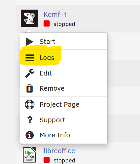

  10. Do logs of other containers work? Resintall a second intance of komf over communicty applications; don't config anything(except port) let it run once and see if you get logs.
  11. Can you recheck for logs? If the webui button does not work try following in console (Change container Name if you changed it in the Template): docker logs Komf
