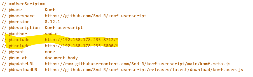

Press the edit button on the far right.
Change the @include sections to your Komga/Kavita instances. Remove or add includes as needed.
Now save the changes under File.
You can now reload your Komga Tab and enjoy the Metadata Grabber.

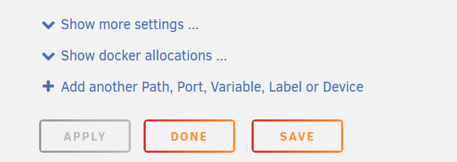

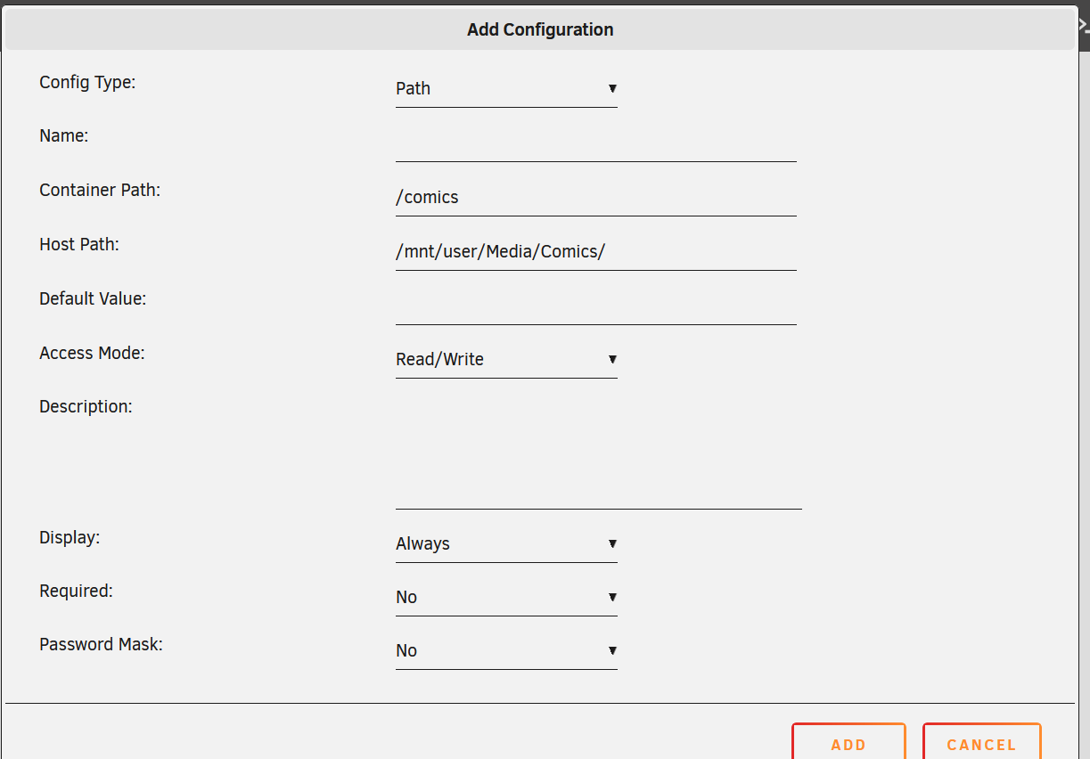

  • Hi,   at the bottom of the screen click on Add another Path, Port ... Configure it for your config, like this: Now press add and lastly apply and wait for the container

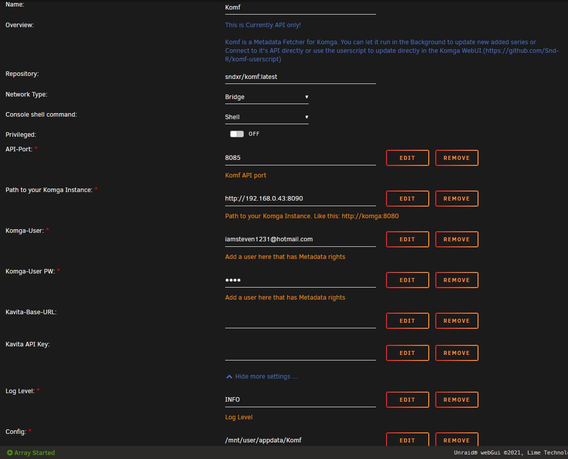

Docker refuses to start with the following error:
13:03:09.689 [main] ERROR org.snd.Application - Failed to start the app
java.lang.IllegalArgumentException: Expected URL scheme 'http' or 'https' but no scheme was found for

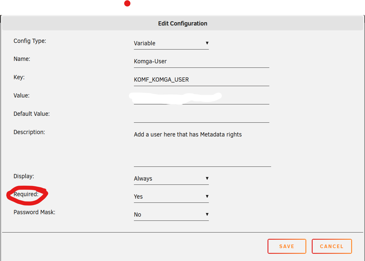

Not sure What to do, as far as I can tell I've filled out all requires fields correctly in the "application.yml" and docker template.

Currently it seems to me that the docker won't accept that the Kavita fields are not filled in.
The Docker normaly should ignore kavita if the event listener is not activated.

I am also running into this. I don’t have Kavita but filed the fields out with bogus strings.

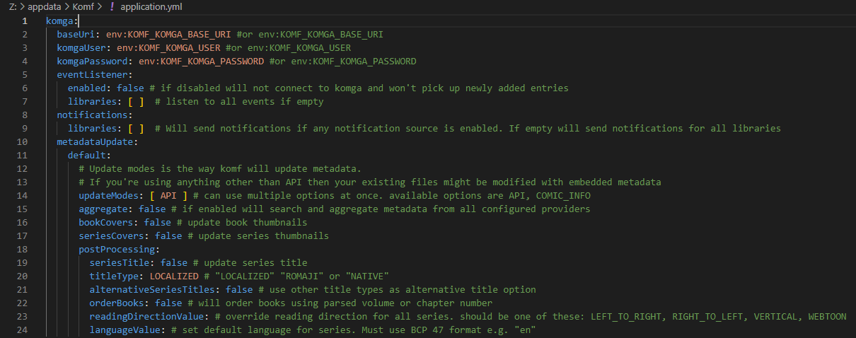

The above issues are caused by the application.yml file not being generated by the docker.
Make one in the mounted config folder following the readme from the projects github and you'll be all good
Also running into this issue. Has anyone been able to resolve this? Even adding the application.yml file doesn't seem to sort it out on my end.

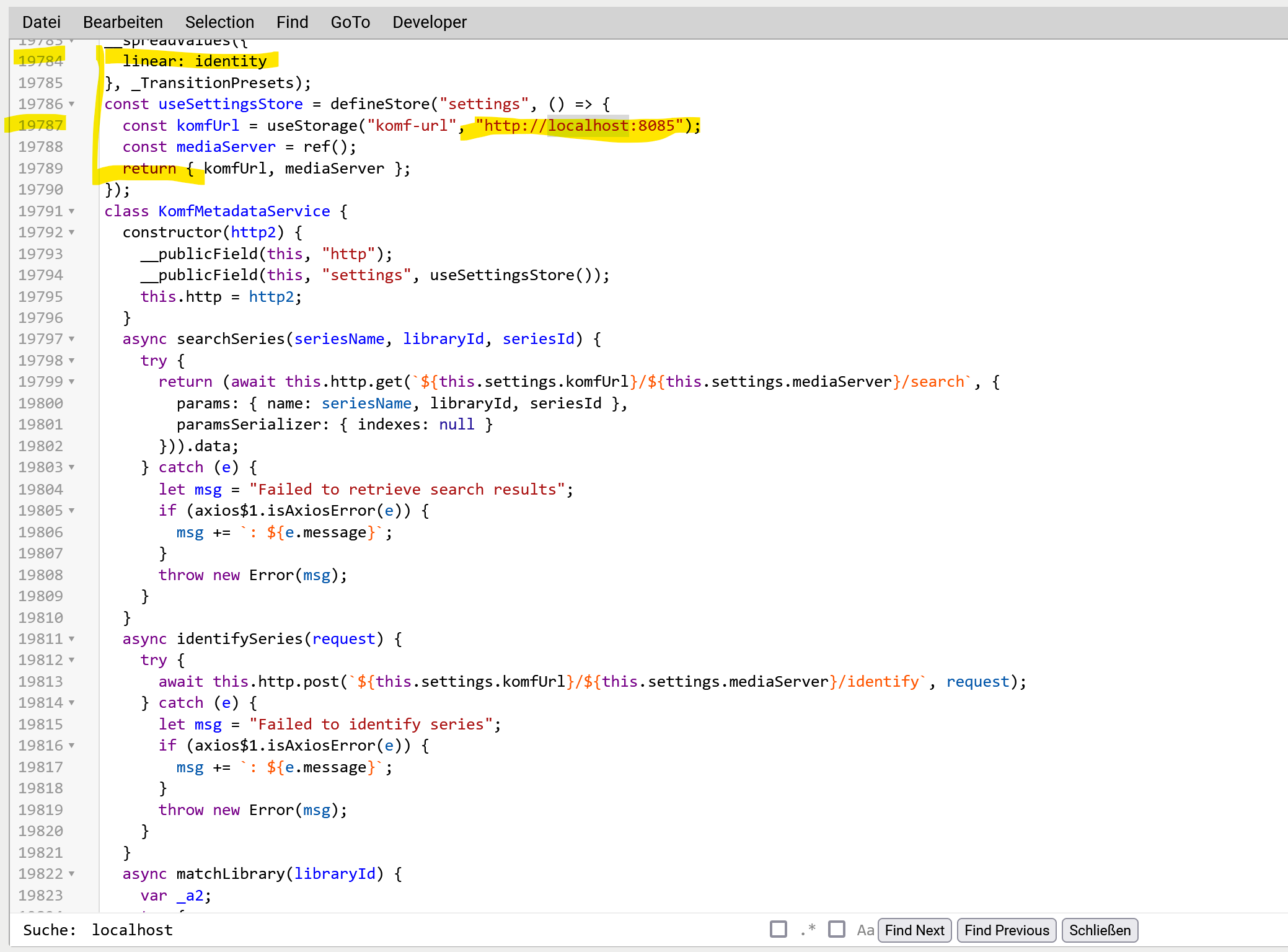

I have issues with the user script it seems. komf seems correct, it dosnt throw out any errors and says its connected to komga, its running on the same custom network as komga which I can access, but I cant get the user script to connect to komf. it tells me there is a network error when providing the url of komf which in my case is "http://192.168.1.4:8085".
Im stumped. Why would the user script not be able to connect to komf?

Hi Ollebro,
I ran into maybe the same Issue.
The Userscript is configured to try to connect to Komf on localhost and 'forgets' your settings when you restart the script.
So i recommend changing the adress in the Script itself (note that after updating your Script you will have to set this again)
In Tampermonkey use Find and search for localhost.
use find next next to the search bar until you see this:
In Line 19787 replace http://localhost... with your Komf server adress. (192.168.1.4:8085) You can skip the http:// it worked without in my case.
That should keep the Script from forgetting your komf adress (until the next script update)
Also make sure you've set your komga and kavita adresses to let the script be active there.
Good Luck, Have Fun

org.snd.common.exceptions.ValidationException: No write permission for file /comics/Above Snakes 001-005 (2022)/Above Snakes 001 (2022).cbz
        at org.snd.metadata.comicinfo.ComicInfoWriter.validate(ComicInfoWriter.kt:145)

I'd appreciate any help on this since I've been bashing my head against this for a few days now.
16 hours ago, magnuspraeda said:
I just set up Komf to try and streamline adding metadata to my comic library. Both Komf and Komga docker containers are up to date as of today.
Now press add and lastly apply and wait for the container to start.
This should work. In the logs we see that it can't write to /comics/... which is the filepath the komga container sees internally. By adding it to komf it will have the access it did not have before.

Success! That fixed it!
Also, you're right that I did have it set to comic_info mode, but I had been getting the same permission error even when I had it set to API. It's working with either setting now, though.

What do we put in the Komga USER and PSWD section if we are only using Kavita? It marks it as required.
Hello,
1. Go to komf update menu
2. Switch to advanced mode
3. scroll to the komga user and passwd section
4. press edit there
5. Switch Required to no
Kind Regards

@C3004 I have everything set up correctly but it just will not connect with the plugin and the logs show it won't even start because of the above error.
I replicated your error.
Remove the Komga Related Part in the application.yml file.
I'm using komga though? What do you mean remove it? Here is what I have with the password and user blanked
I removed the kavita part and got it working. Thanks for the inspiration. I apologize for not being more clear which service I was using!
