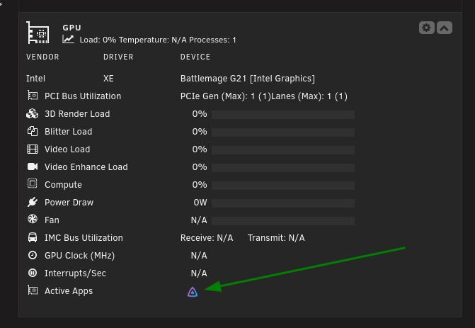

September 17, 20251 yr 17 minutes ago, SimonF said:Intel_gpu_top only works with the i915 driver so will not find the cards using XE.cat /sys/kernel/debug/dri/$pciId/clients should show the clients using the gpu replace $pciid witht the card IP. gpustat has some basic support for XE to show apps but no util etc.Your command shows a stream and i think this is the same as the gpu_stat is doing. In GPU stat i have not much data but i can see if a app uses the card
September 17, 20251 yr Community Expert 1 minute ago, unr41dus3r said:Your command shows a stream and i think this is the same as the gpu_stat is doing. In GPU stat i have not much data but i can see if a app uses the cardYes that is what I use in gpustat. I am working on other options for XE, some are kernel dependant. Utilisation is not provided as far as I can see at present.

April 14Apr 14 Someone has tested the Unraid 7.3 beta with the latest version of Plex Version 1.43.1.10611 (Docker) with the Intel Arc Pro B50Plex Media Server 1.43.1.10611 is now available to Plex Pass users in the Beta update channel.NEW:(Transcoding) Add support for decoding AV1 files on Windows using Intel devices. (PM-4889)(Transcoding) Added support for battlemage GPUs. (PM-3178)(Transcoding) Removed experimental tag from HEVC preferences and enable by default. (PM-4323)Updated Web to 4.159.0FIXES:(Credits Detection) Force detection when manually triggering an analyze operation (PM-4292)(Database) Migrations can fail on startup if malformed JSON data exists in the media_streams table (PM-5166)(Downloads/Optimization) DiskFull and AccessDenied errors are no longer treated as recoverable. (PM-3475)(Editions) The ‘Other Editions of’ hub could return incorrect items for non-Plex metadata agents (PM-4934)(Extras) Cinema Trailers would fail to play on some clients (PM-4296)(Hubs) Collections promoted to hubs on home and library section would not obey label restrictions for visibility (PM-617)(Hubs) The “Recently Added” TV Show hubs could potentially skip shows or seasons (PM-3227)(Library) Server could crash when matching music (PM-4128)(Linux) RPM package could fail to install in some specific scenarios (PM-4863)(Live-TV) Addressed various issues with live-tv playback (PM-5065)(MacOS) Local assets can sometimes be ignored when folder paths contain unicode characters (PM-4271)(Metadata) Add ratings support to NFO parser (PM-4848)(Metadata) Alternate collection image options were not being returned (PM-4799)(Metadata) Critic and audience ratings lower than 10% were not being saved to the database (PM-4894)(Metadata) Embedded thumbnails in episodes were being ignored (PM-4794)(Metadata) Refreshing an item will set its logo again when it has been explicitly unset (PM-4286)(Metadata) Requests for alternate images may return incomplete results if called quickly in succession (PM-4755)(Metadata) Season and episode thumbnails for custom metadata agents would get removed when cleaning bundles (PM-4775)(Metadata) Support spanning episodes in NFO parser (PM-4842)(Metadata) When using the NFO Series provider, running a metadata refresh can get stuck (PM-5019)(Music) Correctly tagged albums with more than 20 discs would fail matching all tracks (PM-4747)(Scanner) Ignore QNAP specific hidden paths when watching for file changes (PM-4070)(Sharing) Newly created libraries would not immediately be visible on “Grant Library Access” page (PM-3961)(Subtitles) Fixes sync issue when transcoding subtitles to webvtt (PM-4847)(Thumbnails) Thumbnails were incorrectly generated for videos with rotation (PM-4035)(Transcode) Transcoding files with an aac audio track could fail with an ios client (PM-5036)(Transcoder) Error message was unclear when all transcoder slots were used (PM-4220)(Transcoding) Burning in subtitles produced a green border for some videos (PM-4795)(Voice Activity) Allow manual analyze to force detection on previously failed attempts (PM-4218)(Voice Activity) Detection could fail in some instances (PM-4066) Edited April 14Apr 14 by vdeleon
April 15Apr 15 Author Community Expert @vdeleon I'm still running the main release branch of both unraid and Plex so unfortunately I haven't gotten to test it yet. Hopefully we'll get the new versions pushed to the stable branch soon.
April 15Apr 15 Community Expert You can also try this if youre running a linuxserver image of plex: https://forums.unraid.net/topic/198283-arrow-lake-video-transcoding-not-working/#findComment-1618506
April 15Apr 15 Author Community Expert Looks like there is also official documentation from the Plex container as well. https://forums.plex.tv/t/guide-official-plex-docker-for-unraid-update-to-plexpass-beta-version/627515
April 15Apr 15 Author Community Expert Solution Sorry for the double post folks. I've upgraded to the latest RC for unraid and the beta channel for Plex. Can confirm my transcoding is now being handled by my B50 without any hiccups.
