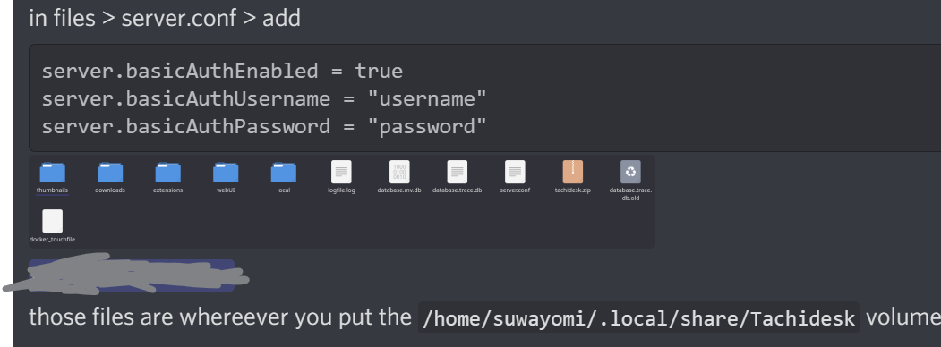

Advanced Config:
Add Password Protection

Password Protection in the Docker:
Just saw this in their discord server:
You can also add simple authentication in the docker config.
But i do not know how it will hold up in reference to the one directly in the reverse proxy.
Edited by C3004
added in docker pw and titels for links
