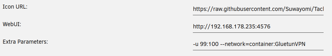

I know it's unnecessary but I am trying to route this through my GluetunVPN. I can't seem to get the configuration to work.
Using Network mode as "None" and adding after the Extra Parameters "--network=container:gluetun" it will successfully launch but I cannot access the webUI. I have added the internal port inside of the GluetunVPN container as well, but when checking the logs in TachiDesk, it shows IP 0.0.0.0:4567 which I think it perhaps not correct.
Any ideas?
Any ideas?
Hi Atreides,
Did you replace the Variables in the WebUI field? When using another container for network access these don't work. This is my Setup:
Replace the Variables with your servers ip adress and the port you gave Tachidesk in GluetunVPN.
IP 0.0.0.0:4567
Expected behavior.
If it still wont work tell me the following:
- did the WebUI work before changing to gluetun
- post docker run
Kind Regards
Thank you for your assistance. I ended up using the VPN manager inside of unraid itself and selecting that network. Still this is super useful as I know I will need to be able to know this going forward.

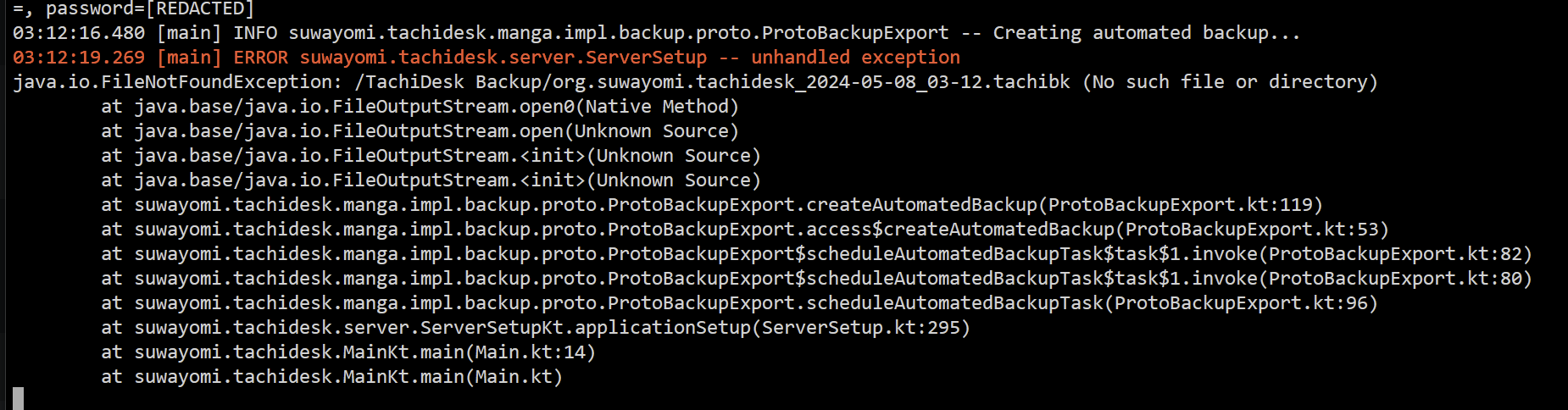

Any idea about this new error after the last update? Everything has been working very well!
this seems to be an error with the Backup process. The folderpath in the Backup settings might be wrong; but i don't know the right path right know.
Thank you very much.
I think I made an incorrect directory location for the backup, used it for several days, and when it restarted it(for update) held up the entire app. Editing the server.conf file and stopping the update fixed it till I could change it in GUI. Keeping the location "" as blank worked.

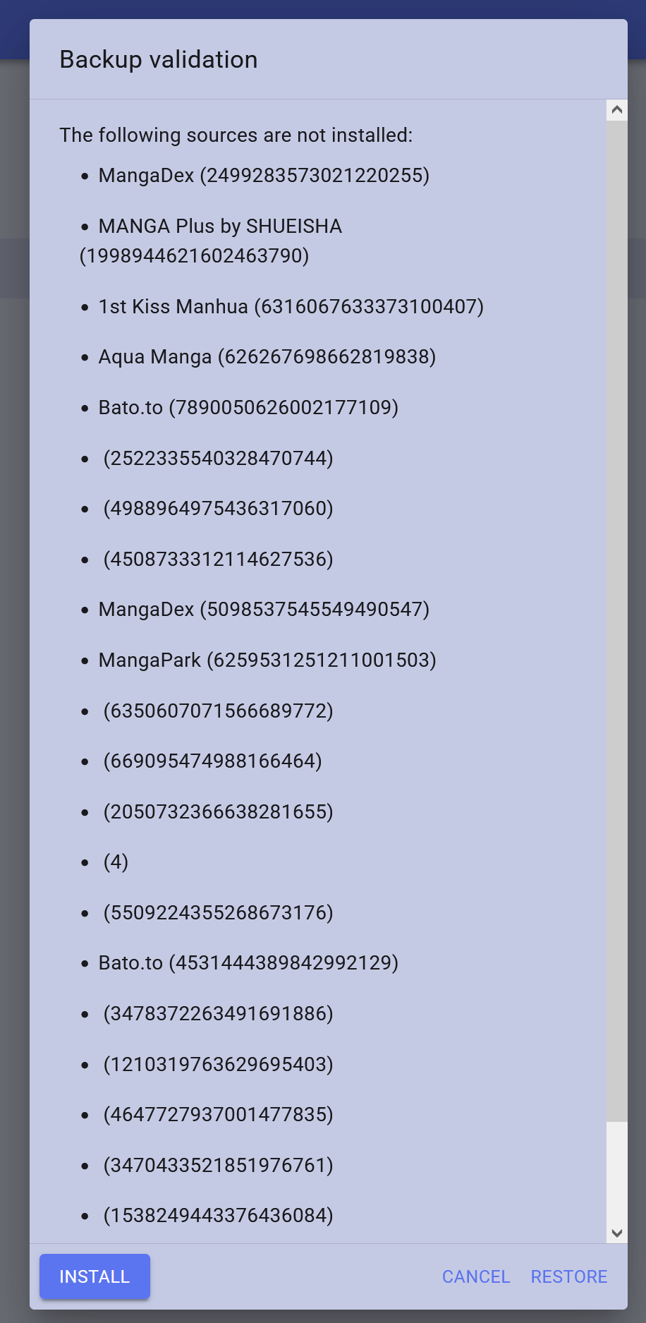

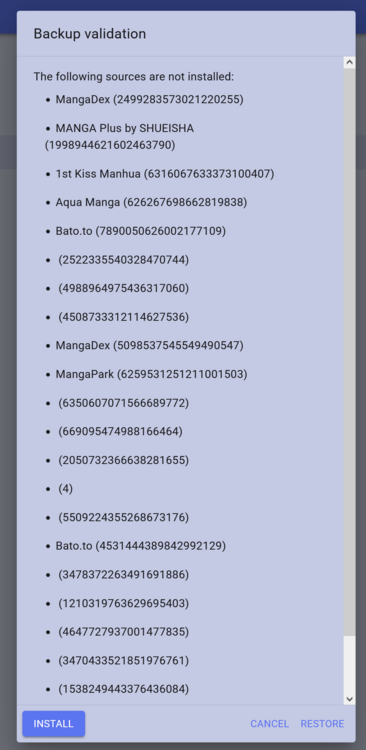

Hello! Wanted to ask if you identified the best way to migrate from preview to latest/stable. I've tried to backup, change to default and restore backup but that didn't appear to work on my end.
Hello Coresplinter,
I migrated fromk preview branch to stable branch with these steps:
1: Create backup in Preview. I got in the latest preview an error creating and later one in using the backup. The stable preview i used is ghcr.io/suwayomi/tachidesk:v2.1.1930
2: Make sure the backup was downloaded to your PC.
3: Shutdown Container
4: Move The Tachidesk folder out of the Appdata folder to use as a Backup! if anything goes wrong and to clean the working environment of tachidesk.
5: Change the Container in the Unraid UI to the stable branch: ghcr.io/suwayomi/tachidesk:stable
6: Start Container
7: In Tachidesk add the Keiyoushi extensions first and download your sources. (If you don't know your sources, the backup function will tell you later)
8: Load Backup in the settings. Depending on the size it could take a while. If the Backup file is correct you should get a confirmation screen if you want to use it.
This will also tell you if you are missing sources. Copy the sources you are missing in notepad to download them later.
Klick Restore to install the backup. Install will send you just to the extension screen.
This is how i migrated my two containers. If there are any problems please ask.

I followed the steps successfully up until 7,
At 8 when I try to use the backup file generated in the preview, I run into the same error I previously had
"Could not validate backup
Exception while fetching data (/validateBackup) : Fields [ip, port, socksProxyUsername, socksProxyPassword, electronPath, downloadsPath, autoDownloadAheadLimit, authMode, authUsername, authPassword, g
Exception while fetching data (/validateBackup) : Fields [ip, port, socksProxyUsername, socksProxyPassword, electronPath, downloadsPath, autoDownloadAheadLimit, authMode, authUsername, authPassword, gqlDebugLogsEnabled, backupPath, localSourcePath, flareSolverrEnabled] are required for type with serial name 'suwayomi.tachidesk.manga.impl.backup.proto.models.BackupServerSettings', but they were missing kotlinx.serialization.MissingFieldException: Fields [ip, port, socksProxyUsername, socksProxyPassword, electronPath, downloadsPath, autoDownloadAheadLimit, authMode, authUsername, authPassword, gqlDebugLogsEnabled, backupPath, localSourcePath, flareSolverrEnabled] are required for type with serial name 'suwayomi.tachidesk.manga.impl.backup.proto.models.BackupServerSettings',
(Removed the rest of the error message as they were line traces I wasn't sure would be beneficial)
The backup was done with everything selected.
EDIT: Maybe the backup should omit client data and server settings?
Edited by coresplinter
Hi coresplinter,
Was the backup created by the ghcr.io/suwayomi/tachidesk:v2.1.1930 preview version?
