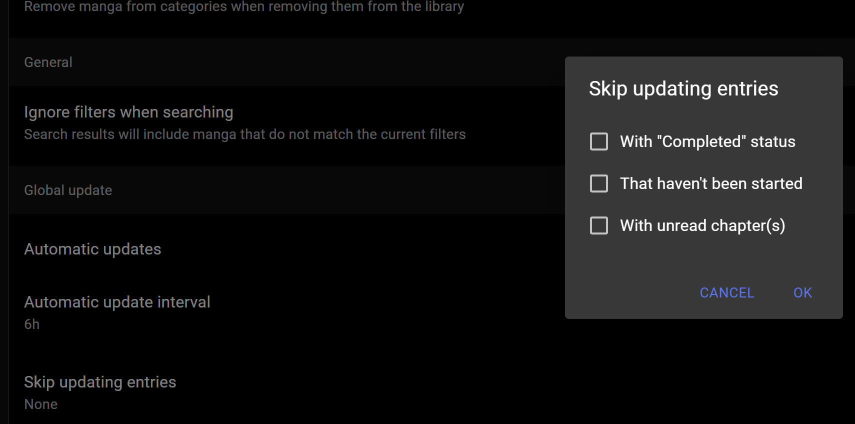

On 10/30/2025 at 1:32 PM, zinkpro45 said:
Seemingly having an issue with this where it just doesn't check for new issues automatically. Has anyone else ran into this? I'm only using the Weeb Central extension as a source. Going to a manga and clicking update manually grabs everything new, but then it just won't check automatically after that.
Disregard, didn't know that "Skip Updating Entries" blocks this. I had to update the setting to be something closer to this:

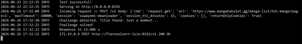

Hi!
Having tested mangakakalot on my instance flaresolver must work or the site can't be accessed.
My flaresolver log is:
In what network mode is your flaresolver and tachidesk container?
It seems you only got a response from flaresolver when you had the tachidesk container in the host network mode, so it was using the host unraid network stack, which means the requests went through your home network, which can lead to many issues. (Ports you map in docker edit are mapped from the internal docker network to your servers ip adress. Only containers in host mode can access other containers this way)

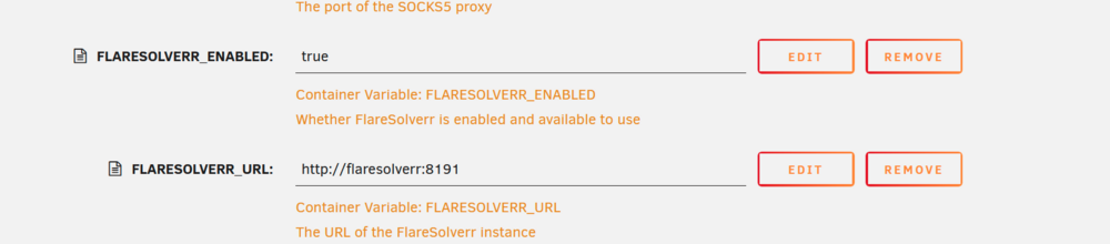

For better communication we want the containers in the same network stack. We can either use the base unraid bridge network and use the container ip's (set according to container startup; ip needs to be locked otherwise it changes almost every time) or we use a user defined docker network, in which the container name is the container hostname and can be used instead of the ip.
I don't want to bother with the standard docker bridge so here is the setup for the user defined bridge:
  • create bridge in unraid console: docker network create manga
  • edit flaresolver container, set network type to custom: manga
  • edit tachidesk container, set network to custom: manga
  • scroll down to show more settings; set allow flaresolver_enabled to true; set flaresolverr_url to http://FLARESOLVERRCONTAINERNAME:8191
Try this. If it doesn't work please share the flaresolver logs too.

  3. I then configured flaresolver url to "http://flaresolverr:8191" in the tachidesk container, restarted and got the following in the logs:

Flaresolverr Log (Note:when I browsed Mangakakalot in the webui there was not change in output almost like tachidesk did not access it):
2026-06-27 20:45:25 INFO     ReqId 22780464257920 FlareSolverr 3.5.0
2026-06-27 20:45:25 DEBUG    ReqId 22780464257920 Debug log enabled
2026-06-27 20:45:25 INFO     ReqId 22780464257920 Testing web browser installation...
2026-06-27 20:45:25 INFO     ReqId 22780464257920 Platform: Linux-6.1.126-Unraid-x86_64-with-glibc2.36

These are the settings in my tachidesk web ui:
Whenever I try to access the Mangakakalot extension, I get that 0.0.0.0:443 error and I don't see any activity in the flaresolverr container logs. When I run the following curl command "curl -X POST http://flaresolverr:8191/v1 -H "Content-Type: application/json" -d '{"cmd": "request.get", "url": "https://mangakakalot.gg", "maxTimeout": 60000}'" from the Tachidesk console, I see activity from the flaresolverr logs. So it looks like for some reason my tachidesk docker container is refusing to access flaresolverr even though it should be configured. I am running "ghcr.io/suwayomi/suwayomi-server:latest" for my Tachidesk-Server repository.

Lastly enable debug logs in tachidesk and check what it says. Heres mine:
One should first get the 403, then it should recheck over flaresolverr to get workable cookies and smoot sailing from there.
