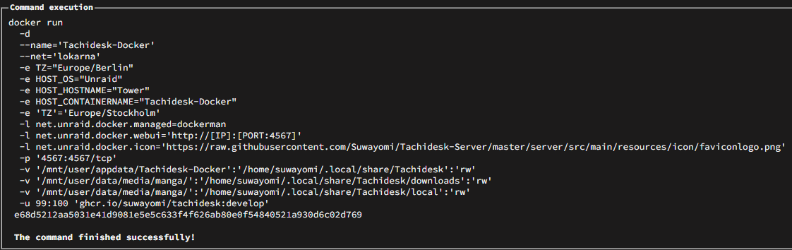

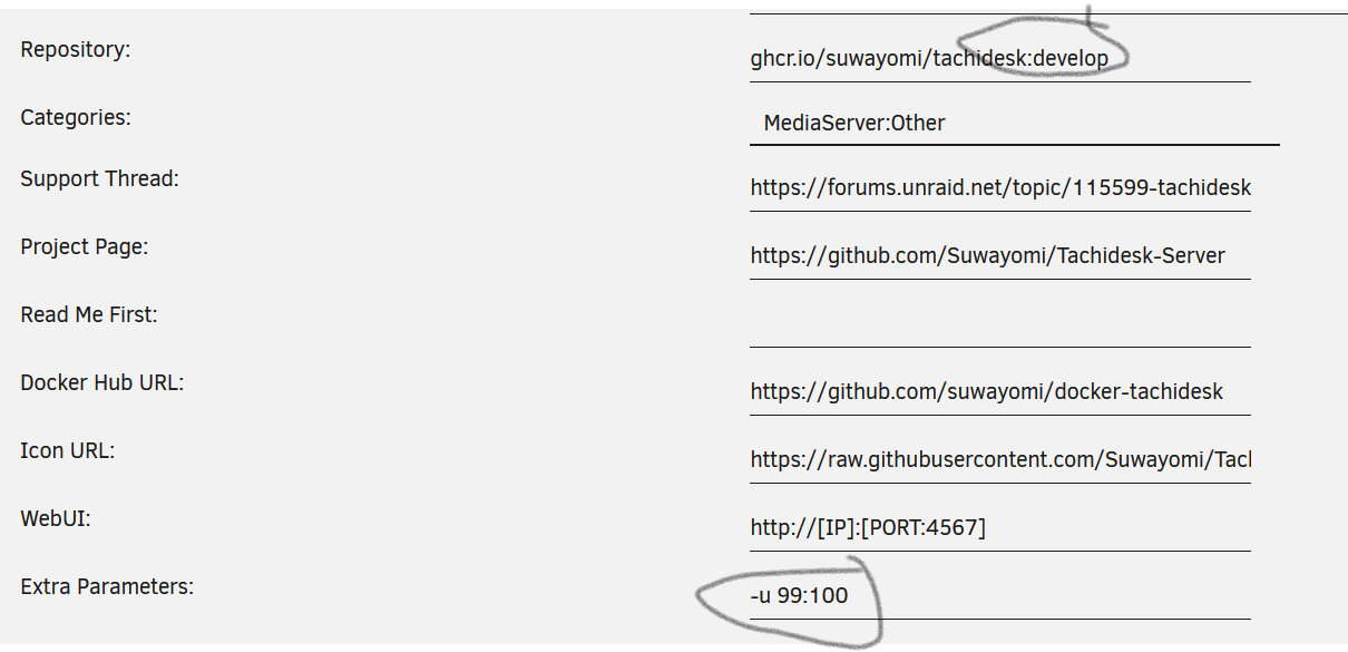

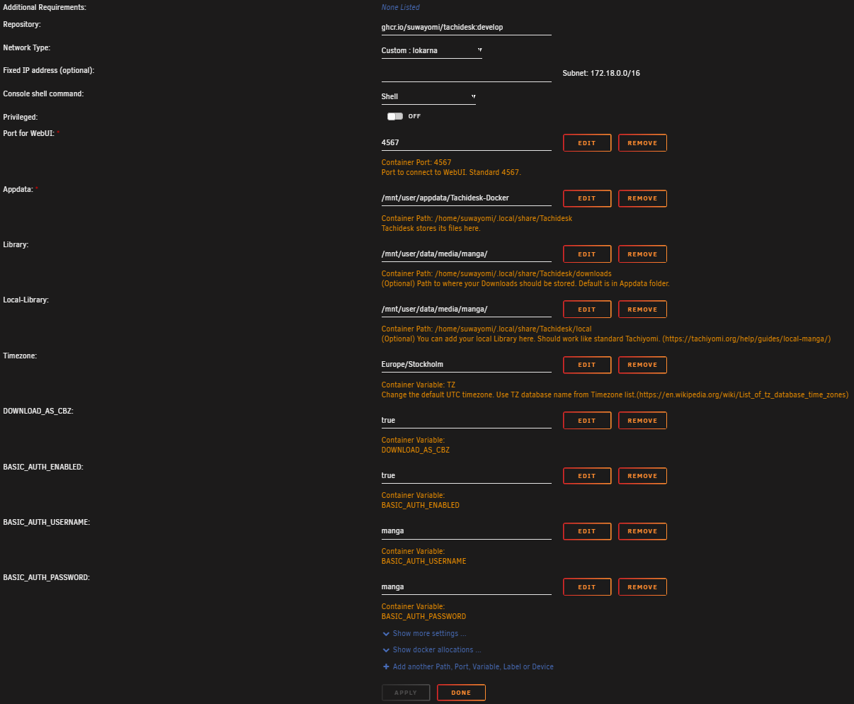

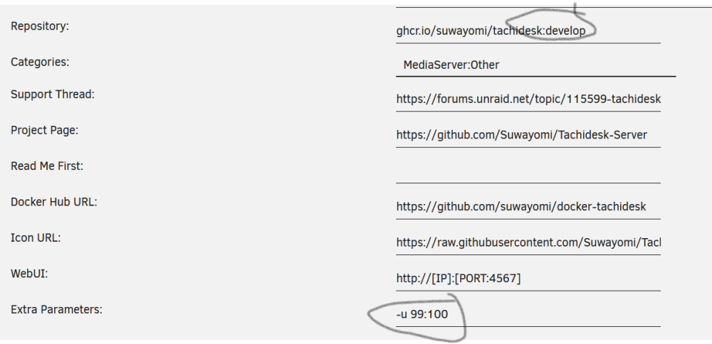

They added a function to the development container to change the running user. (https://github.com/Suwayomi/docker-tachidesk/issues/22)
Activate advanced view to make these changes
Change **Repository** from "ghcr.io/suwayomi/tachidesk" to "ghcr.io/suwayomi/tachidesk:develop"
Add in **Extra Parameters ** "-u 99:100" without quotations
It should look like this afterwards:

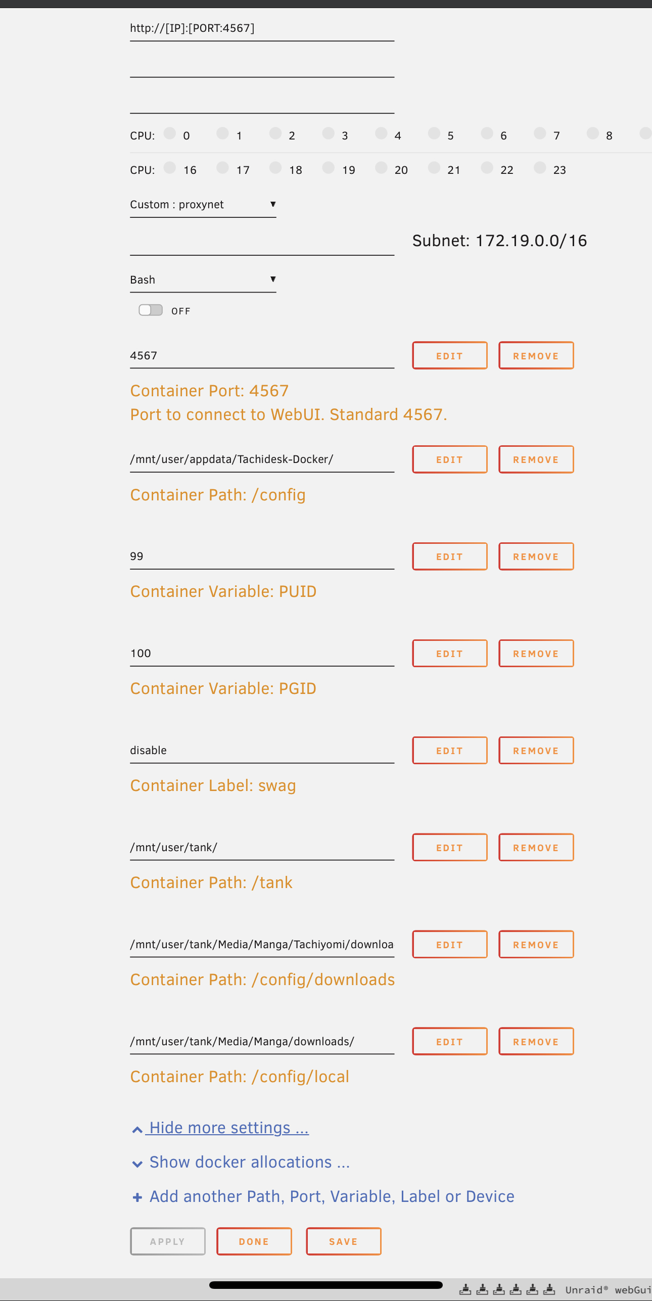

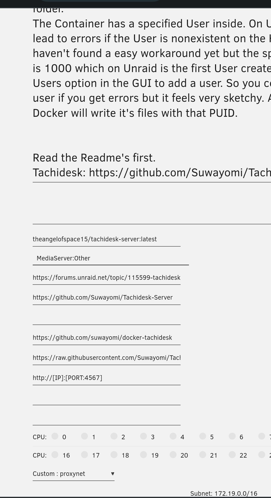

    Well, i didnt see any comment lol but in case anyone eant to give ot a try this os how it looks. `Config` is your config file, `/config/download` the folder the app downloads manga, `config/local` you
Thank you so much for posting this.
I havent have time to check but it shouldnt be hard by changing the dockerfile. I might yake a look one day. I have not been using tachidesk so I stopped T/Sing.
I saw a new update, but can't find the change log. Any idea what was changed?

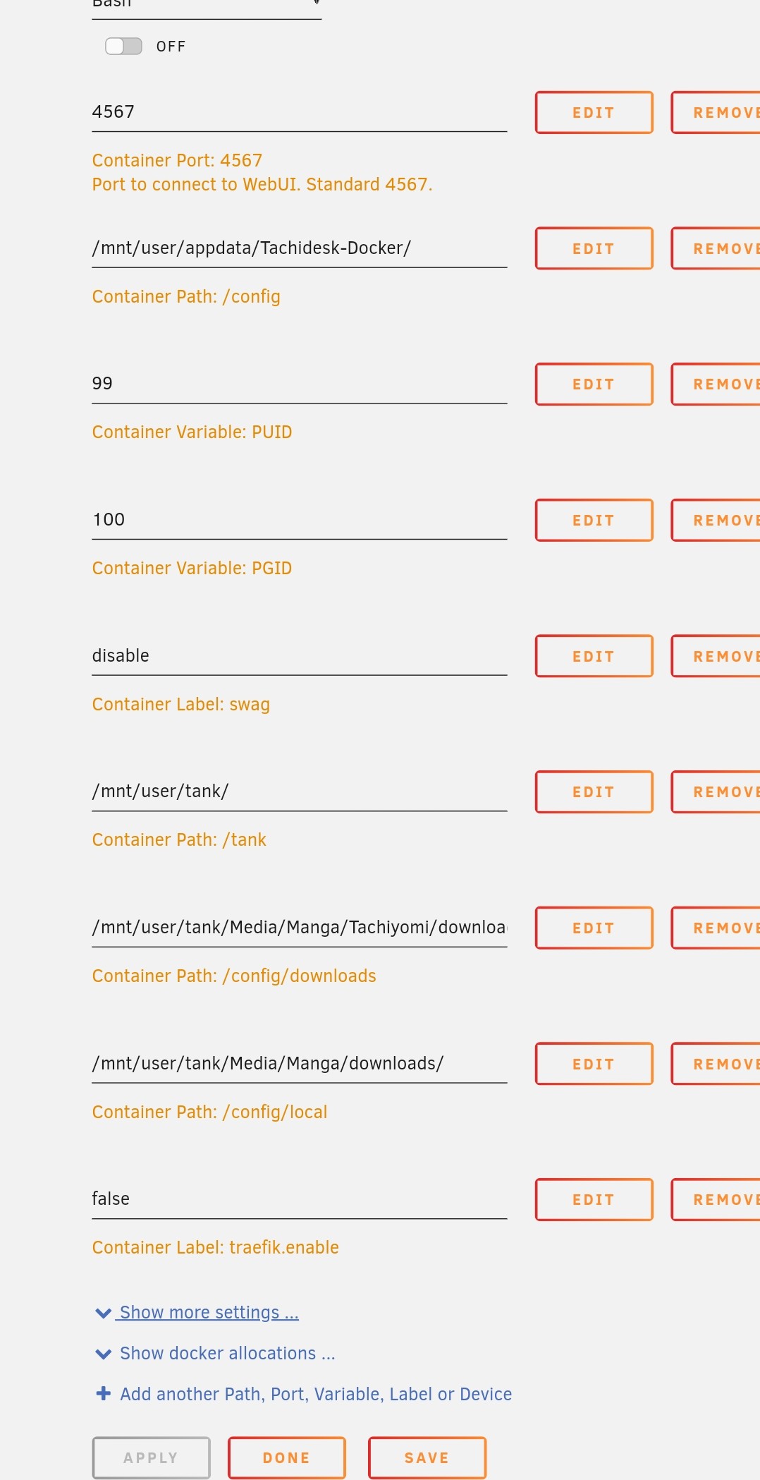

If you are still having problem. Try this container. `https://hub.docker.com/r/theangelofspace15/tachidesk-server`
or change you image to use `theangelofspace15/tachidesk-server`
Set
`PUID` to your user id
`PGID` to group id
`/config` to your config file (like: /appdata/tachidesk`
`/config/downloads` to download folder
`/config/local` to local library
the image is based on linuxserver alpine base images so it should use things like docker mods but I havent test it.

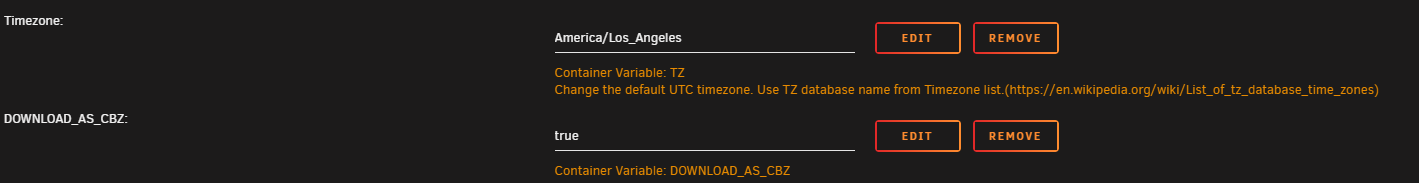

This fix works for me, but even though I added the environment variable DOWNLOAD_AS_CBZ to true, it does not download into cbz. It keeps the structure as Manga Series > Chapter > images files.
Does anyone know of a fix for this? Thank you.
Hi Soldius,
That variable is new and currently only in the preview containers.
Please note that the fix only works with the develop container.
I wrote about the Fix before the tachidesk guys made a full rewrite of the docker container. The rewrite happened two weeks ago. The Variable you want to use is part of that new rewrite.
As the fix only works in the develop container and the latest update of that one was 18 Days ago the Variable is currently not available in that one.
Best Regards
Edited by C3004
