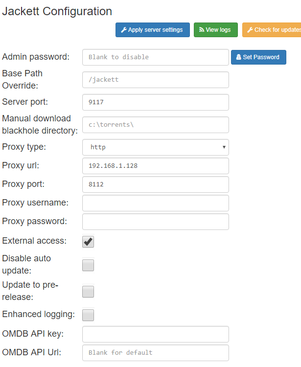

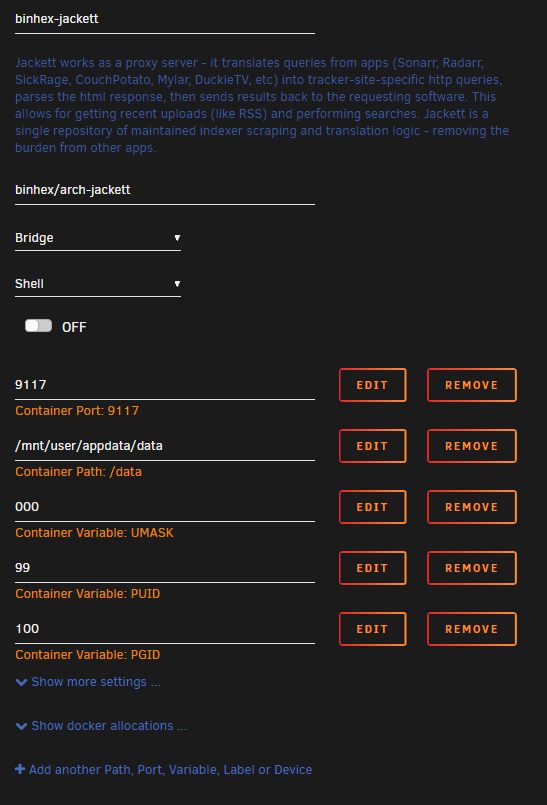

Sure thing!
JackettConfig.PNG.d185f4c9fc9787813f1e1a8bbc1ff7d3.PNGJackettDockerConfig.thumb.PNG.45009960566f7b4095d82f3aa47cf303.PNG
I do notice you have different downloads folder.
Also if you remove that info does it work?

I removed the proxy from the settings and it still fails.  I know I have DelugeVPN set up correctly because my torrents are correctly downloading from my new IP.  I noticed that video doesn't mention Jackett at all, did I miss it?

Deluge? Yes, using it now.  Jackett? Only the first day, it stopped working after an update.
I use a proxy with Jackett and have had problems adding trackers that are blocked by my ISP. Can you add any trackers?
My ISP doesn't block it as I can navigate there in my browser.
Some more strangeness.  I was able to add the tracker from a fresh install of the docker, but the second I added the proxy info back in it starting failing.  Adding to the confusion, when I removed the proxy info it STILL didn't work.  The proxy does work though, my Deluge is reporting the correct VPN IP...

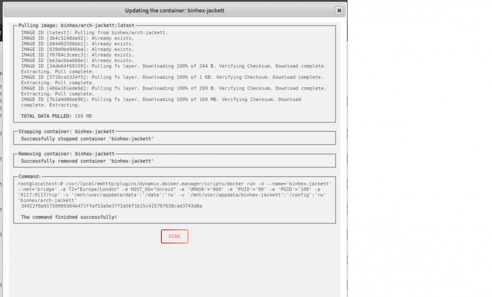

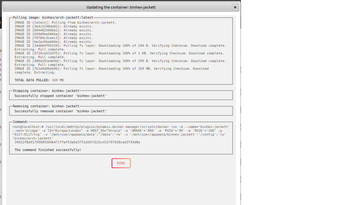

Hello I have been having an issue updating the docker container for jackett and delugevpn both are having the same problem I click on the update text it appears to download and extract all but one of the downloads redoes the container and say completed when I click on done unraid reports the update has not been applied. i have attached a screenshot of the update process i have also tried the update all button in the unraid docker tab but get the same result i have restarted the server multiple times again this has had no effect. all other containers seem to update fine but these two.
Can you advise away to fix this?

My hunch that it's an issue related to Jackett + proxy + CloudFlare.
It could be something related to CloudFlare, which I understand iptorrents recently added. I don't know too much about how CloudFlare works but it sometimes initiates a DDOS prevention page before sending you to the actual page. It looks like this. I believe Jackett is set up to handle them but perhaps there's an issue with CloudFlare in combination with a proxy?
Since CloudFlare DDOS page happens intermittently perhaps that's what's creating intermittent results. But I'm just guessing.
