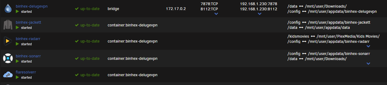

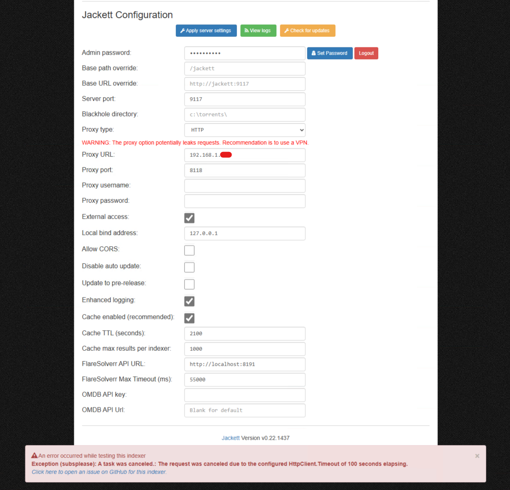

Good day!
I'm having an issue where jackett can't successfully test any of my configured indexers.  I noticed that it appears to have started to fail when I updated to Unraid 7.0.0 (based on when my most recent sonarr/radarr files stopped).
2025-02-21 20:14:41,869 DEBG 'jackett' stdout output:
02-21 20:14:41 Warn Request to SubsPlease failed with exception 'The request was canceled due to the configured HttpClient.Timeout of 100 seconds elapsing.'. Retrying in 1.317882s.
Jackett is going through delugevpn as a proxy as are sonarr and radarr.  I can use sonarr and radarr to look up shows and movies so I'm pretty confident my proxy is OK.
Any help would be appreciated.
