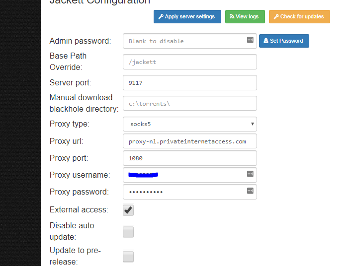

Having issues with getting this to run behind proxy. As you can see it shows my real IP.
