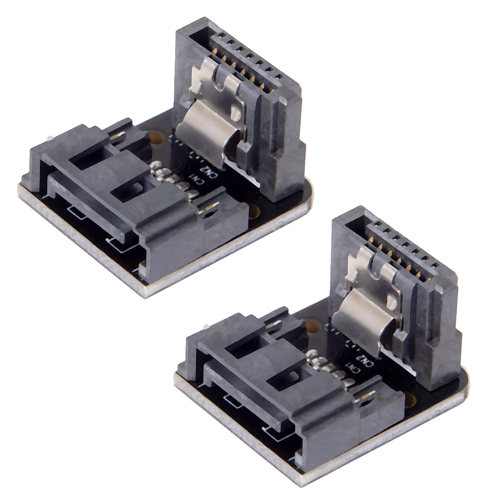

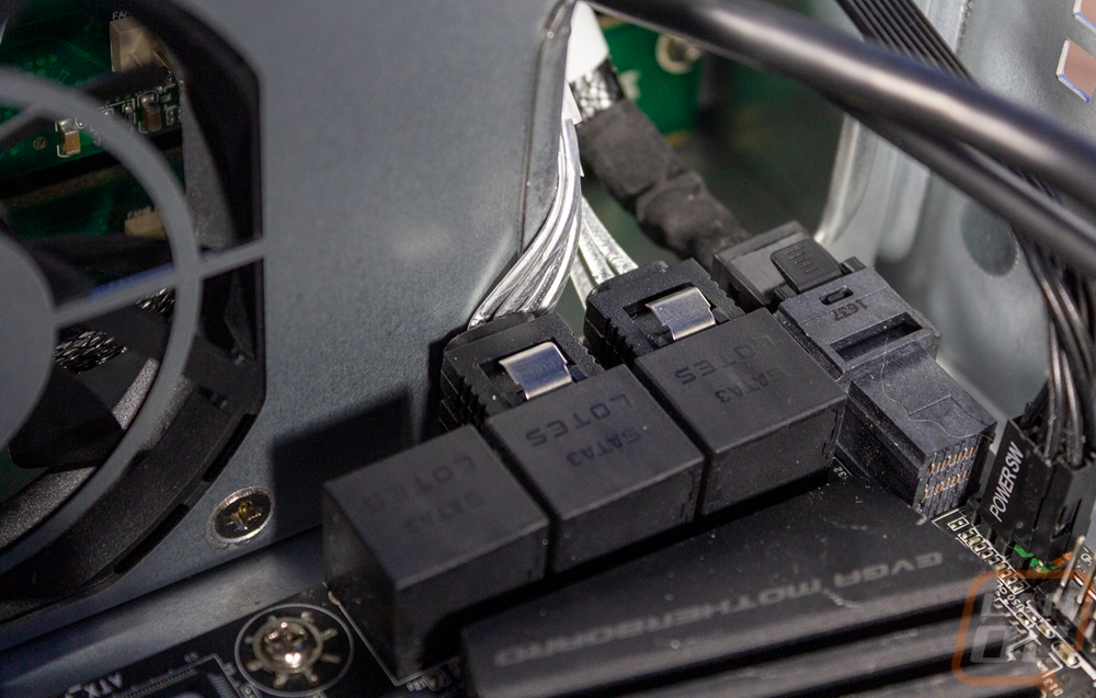

Limited Space Between Sata ports and Case - Multiple Angled Sata Adapters for Motherboard?
Ha, didn't even think of that. I suppose that would work. May resort to that if needed. Interesting. I assume that would be something like this, or this? Are there other benefits of using an add on sata controller, apart from being easier to plug in?
I am about to start putting my new build together, and I came across a blog where someone used the same case as me. They had an issue where the sata ports on the motherboard were angled sideways which made it difficult to plug in the sata cables due to being really close to the wall of the case. This is how tight it was for them: https://lanoc.org/review/pc-hardware/8346-project-data-hoarder-truenas-core-build-part-4-psu-rails-and-installation?start=2 My motherboard also has sideways facing sata ports and the sata ports are in the same location on the board, so I think I will have the same problem - especially since the cables I will be using look like they have bigger ends than those used in the blog. So, I am thinking this could be solved with some angled adapters or similar. I have found some online such as this: However, since the sata ports are stacked one on top of the other, I would only be able to use one of these for each column of ports (4 in total). I was thinking I could get 4 short adapters and 4 long adapters (which reach over the short ones), but I haven't been able to find any long ones. Does anyone have any other ideas for solutions to this problem?

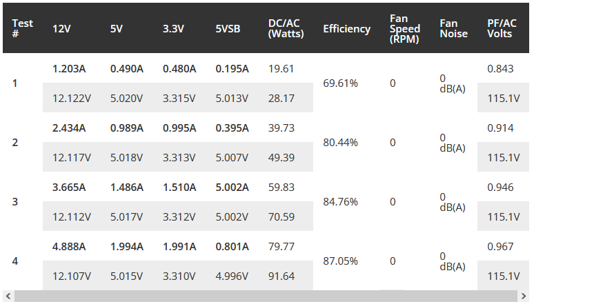

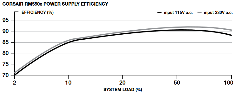

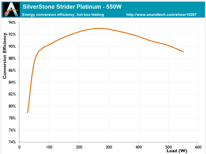

I've looked up some data on the Corsair, and it does seem to be really efficient at low power. However comparing to the Silverstone I think it seems pretty similar? (Not trying to prove you wrong, or defend the Silverstone - just trying to make sure I'm not missing anything). https://www.corsair.com/corsairmedia/sys_master/productcontent/WW_RMx_Series_2021_QSG_AA.pdf https://www.anandtech.com/show/10207/the-silverstone-strider-platinum-550w-psu-review/4 Corsair RM550x: https://www.tomshardware.com/reviews/corsair-rm550x-power-supply,4484-5.html Silverstone 550w: https://pcper.com/2016/10/silverstone-strider-platinum-550w-power-supply-review/5/#ftoc-heading-6 Seems like at 55w they are both around 84-88% efficient and at 20w they are around 75-78% efficient. It's kind of hard to tell exactly without precise markings on the graphs, but they seem pretty close. Do you have any other links about the Corsair's low power efficiency vs others? Or is the Corsair just better at going down even below 20W which isn't measured by these charts or something? Yeah I agree 32GB is plenty for the time being. I was originally looking for a single 32GB stick to leave upgrade options open (and saving power would be nice too), but I couldn't find any 32GB sticks at 2400MHz that were unbuffered - they all seemed to be buffered/registered. Like you said - availability really limits choices.
